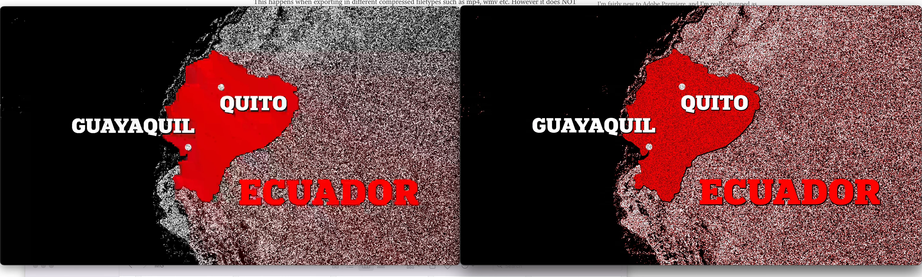

I just encountered a strange effect that gives me a lot of headaches in the middle of a deadline. I've never seen this before:
I have a sequence with some graphics, and some of them have red in them. In the preview and in screenshots / single png frames, everything looks perfect, but when rendering, the exported clip has this strange pixelation at the red areas (see screenshot below: left is a single frame exported / right is screenshot from the exported sequence).
This happens when exporting in different compressed filetypes such as mp4, wmv etc. However it does NOT happen when exporting a large quicktime file. But when I recode it in Media Encoder, the problem returns.
I have documented this on two different workstations both running CC 2017.
the logo files are pngs, but the effect still happens when I save them as jpgs and place them into the sequence. Size of the logo does not matter, the only way to keep away the pixelation is if I use some other color than this red.
What kind of witchcraft is this? Can you help me? Thanks!

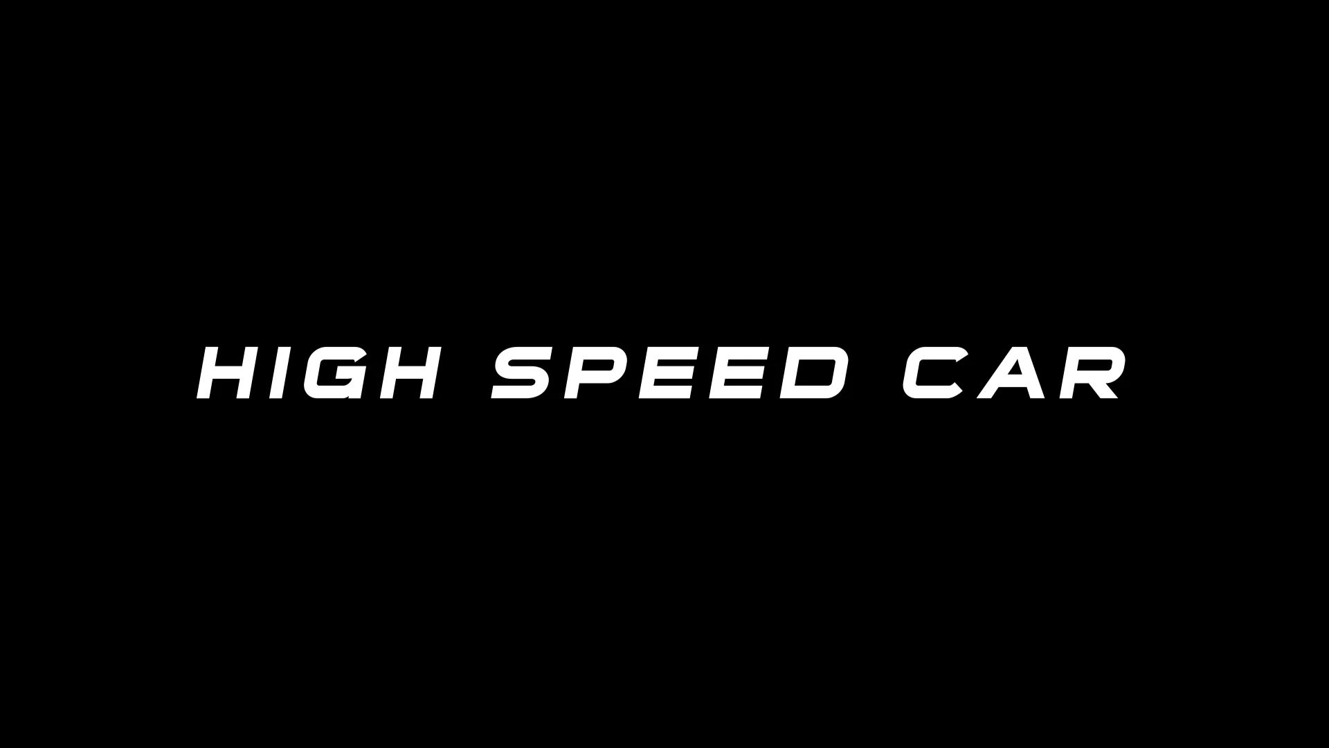

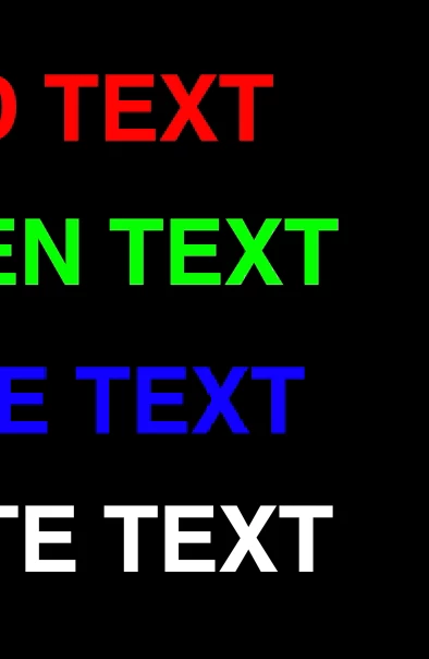

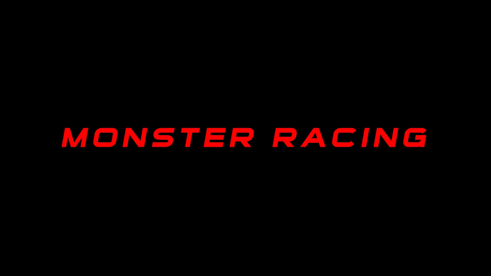

ExportPngClipH264 - For this video, I put some text over a still frame image in Photoshop, flattened all layers, saved as PNG, then imported that into Pr 14.0 and exported using the H.264 format and Match Source - Hight bitrate preset.
Also see:
ExportPrTextH264 - For this video, I put a Pr Text Layer over a video image in the timeline and then exported using H.264 format and Match Source - Hight bitrate preset.
The same pixelation problems are visible whether you are using Premiere Text Layers or burned in Text from Photoshop or elsewhere. We also tried some tests using other Adobe apps and some Non-Adobe apps and the same basic problems were evident in each case.
So what we're seeing is compression artifacts. Most major compressed video codecs are perceptual. These codecs have to choose which details to preserve, and the green channel (which corresponds roughly with the Y channel) preserves much more detail than blues and reds. Perceptual codecs like H.264 have always been much worse on text than images, and particularly on text with no green channel.... like bright red text. (RGB 255,0,0)

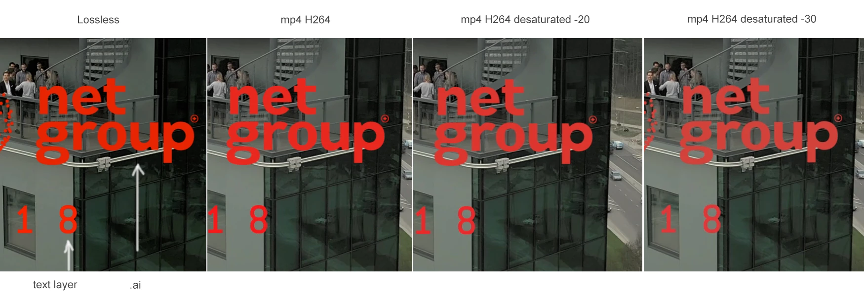

May 30, 2019 1:17 PM UTC
I don't know how would it help, tho there are many previews at the beginning of this thread, but ok, here's the comparing. I also noticed that it's not about H264 codec, because Apple ProRes 422 did the same job.
And it is very easy to replicate. Just add pure red text on darker image or footage and voila. Tried it on another computer as well, just to be sure, it's not machine related. Same same.
