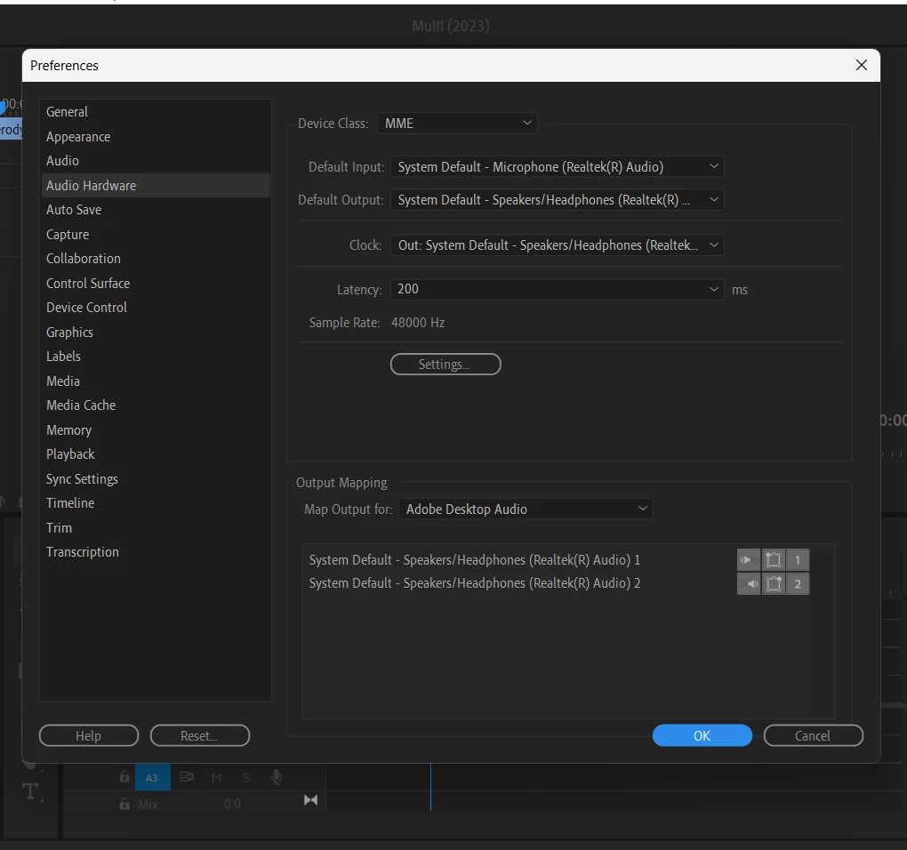

Your recommendation of Preferences>Audio Hardware>Default Input... to "No Input" seems to have fixed it! Can you tell me what those settings do? Thank you.

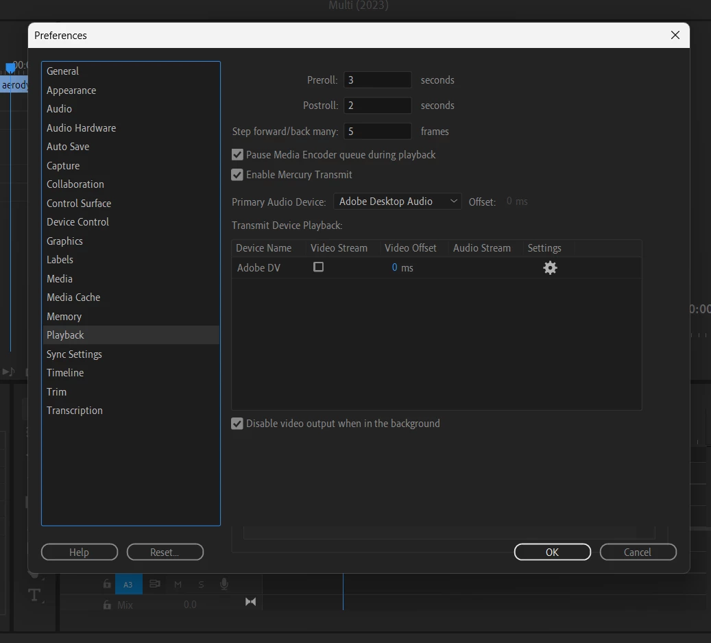

jer333Author
Aug 30, 2023 9:32 PM UTC
 Hi. Hope these work.
Aug 30, 2023 4:56 PM UTC
Can you post a screen shot of "Preferences>Audio Hardware..." and "Preferences>Playback..." so we can try to diagnose the issue?
Then, try setting "Preferences>Audio Hardware>Default Input..." to "No Input" and see if that helps?
