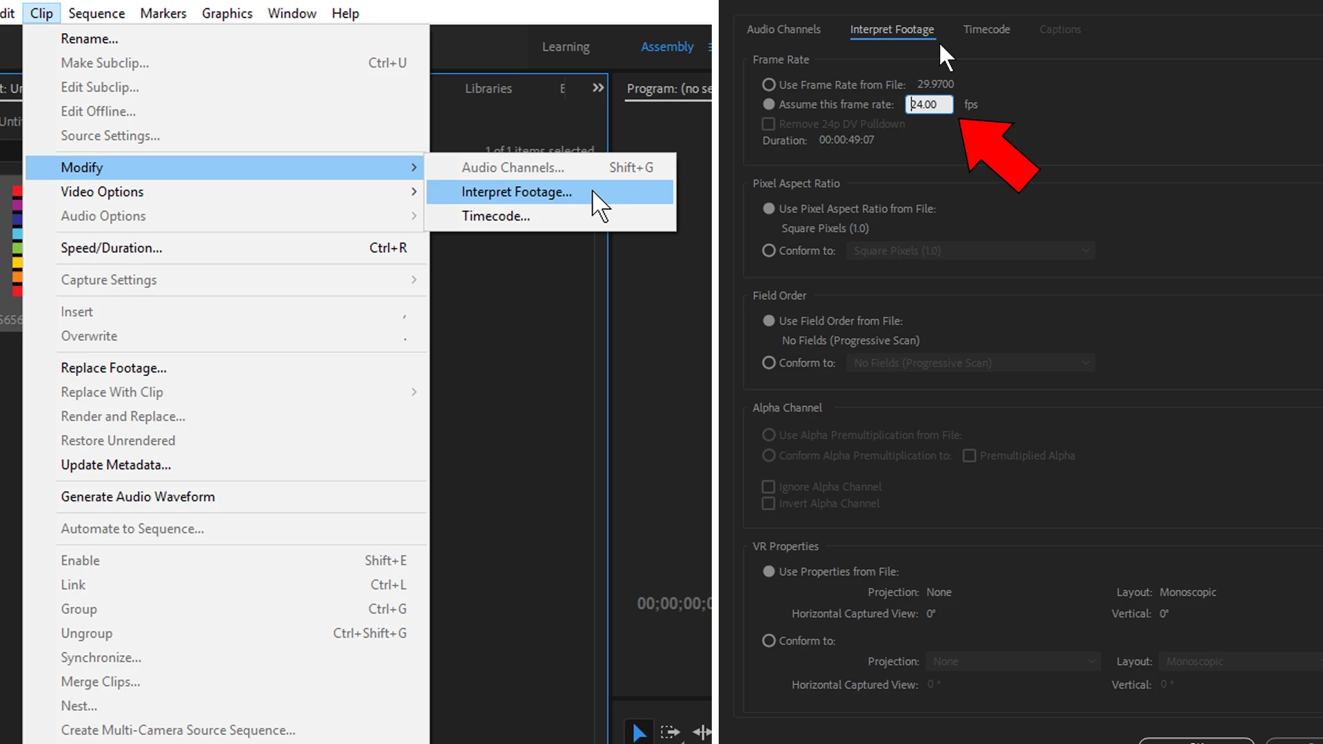

    If you are using true HFR footage at 120fps and you want SLOW MOTION do the following:
    • Import your video clip(s) and then SELECT them in your PROJECT WINDOW/BIN.
    • Go to CLIP > MODIFY > INTERPRET FOOTAGE
    • Under FRAME RATE, select ASSUME THIS FRAME IS and make it 24fps (or whatever frame your sequence will be).
    This will give you true slow motion at 24fps. Now you can edit your clips in a 24fps sequence and your clips will be in slow-mo. Note: HFR clips modified this way will make your clips longer.
