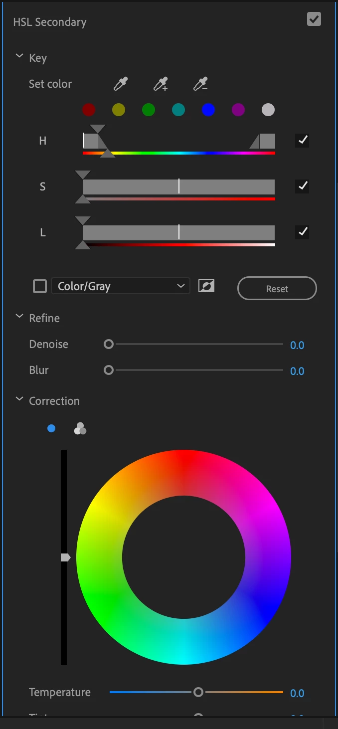

Sorry not to have made it clearer what I used, below a screenshot, I was using HSL secondary throughout (picked the color of the bag, fine tuned which color I wanted it to be, then used the mask tool in a hope that it would autodetect the same for subsequent frames). Is that what you meant or did you refer to something else? Thank you.
