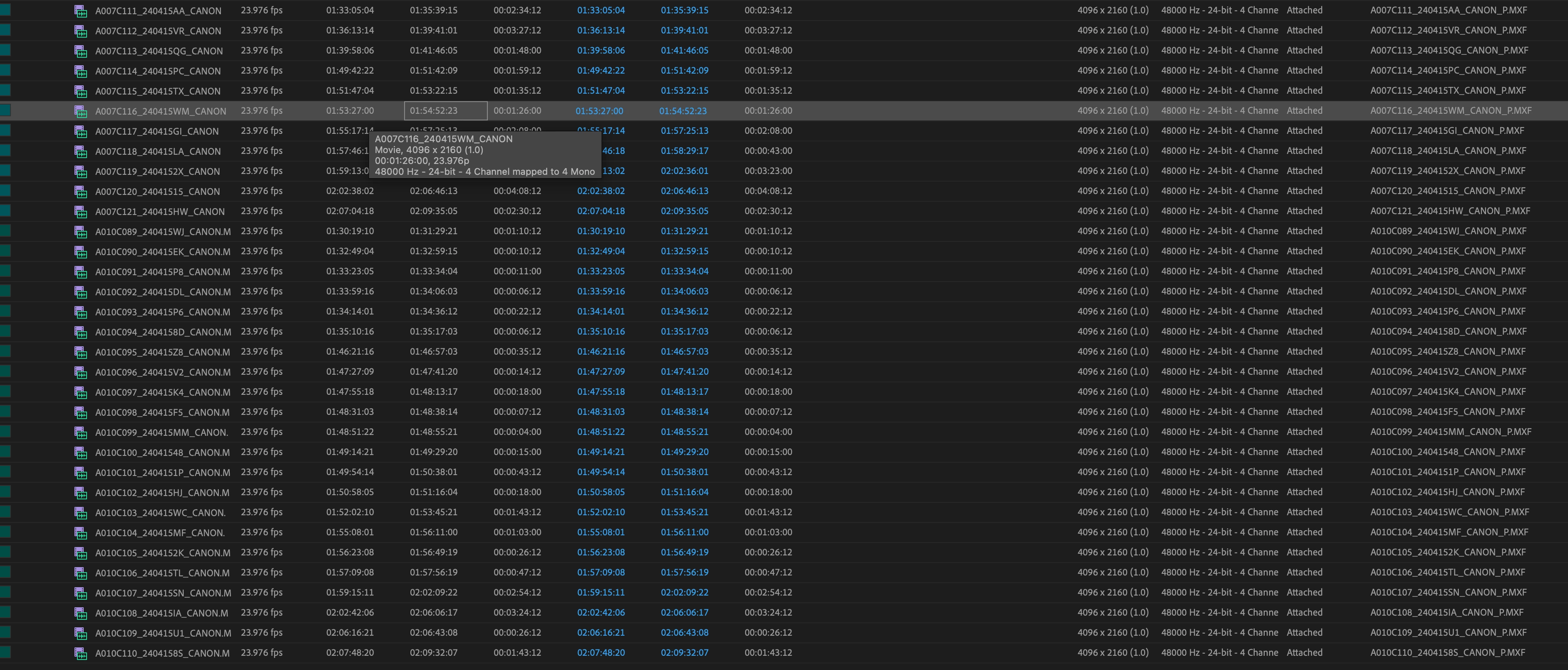

The DJI files are the least of my worries. All I do is render them out and they play. Nevermind the proxies. That being said, no proxies will play, whether recorded in-camera or created using AME. I haven't had the time to deep dive into this any further b/c of looming deadline. File info attached in photo.
