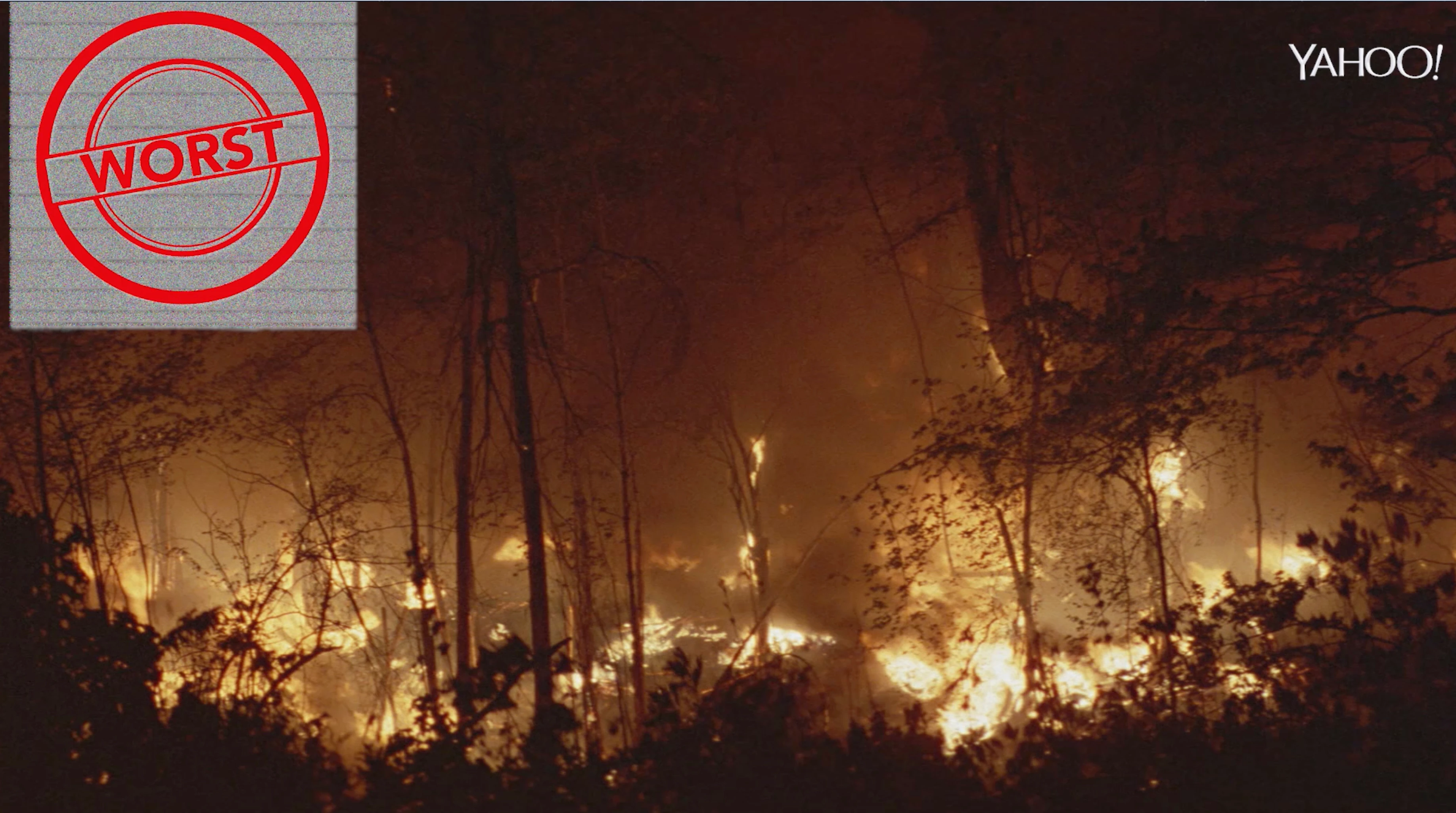

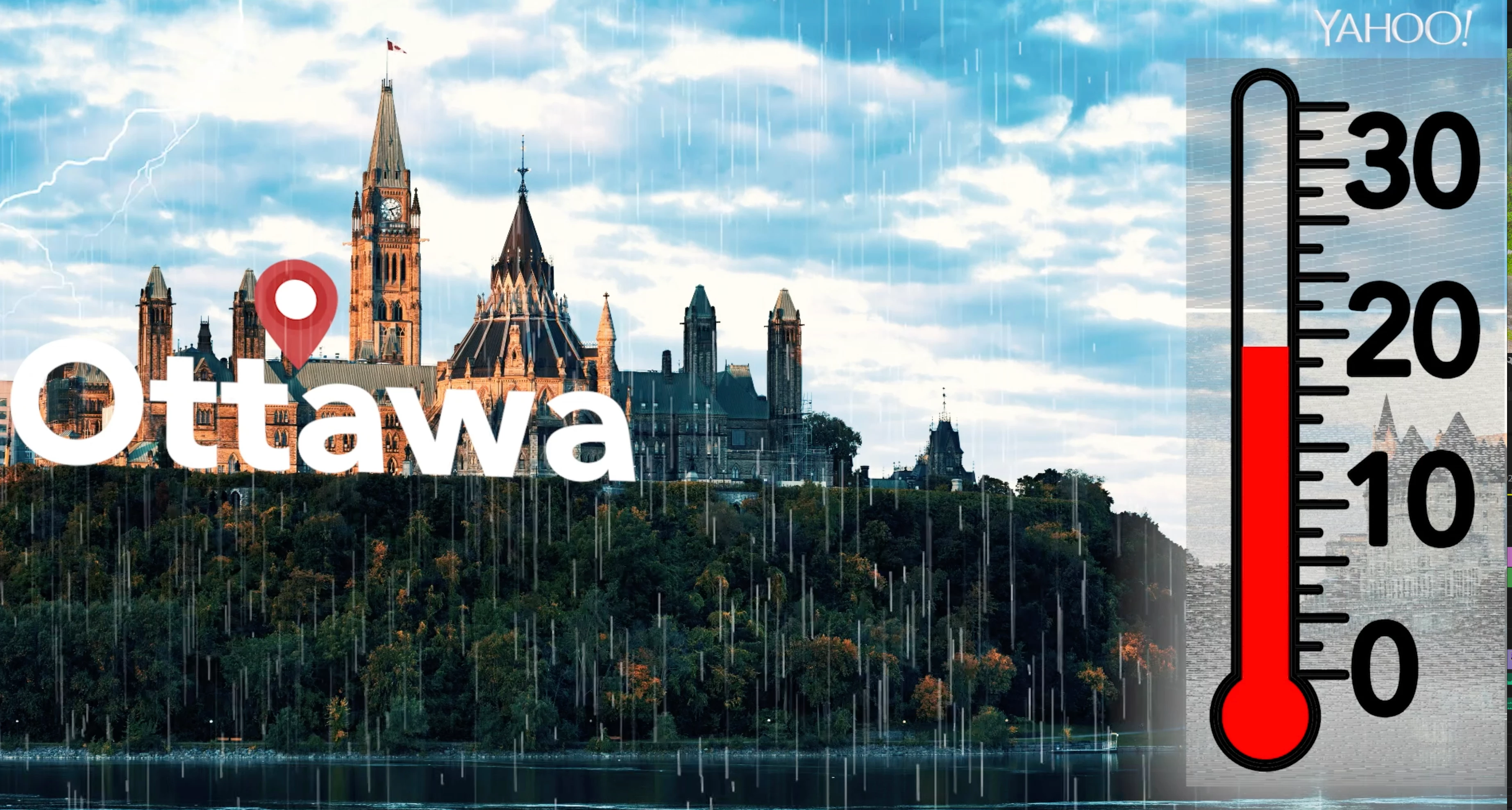

Hey guys,
So my PNGs randomly export with static. Sometimes it exports clean, sometimes it doesn't, and it seems to be a different file each time that has a problem.
I've tried going through multiple passes while exporting, but I still seem to have the issue. Sometimes I have to export the same video 4-5 times before it comes out fully clean. Any possible solutions? I've attached some pictures below so you can see what I am talking about.
Thanks
