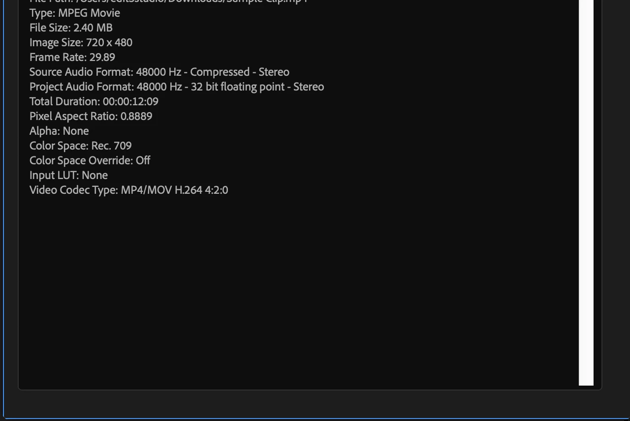

I have been transferring family VHS tapes to digital using my two Mac computers with El Gato and Diamond Video capture cards and the footage looks great while transferring, but the exported files look terrible when the camera moves (pixelated motion). I am using vcrs with a built in TBC, and are inline with DVD recorders with TBC/DNR. I'm still fairly new to Premier Pro, does anyone know of any settings that can help with the motion pixelation? Thank you!

Media Info Tool detects this footage as 29.97fps. See attached text file.
It also says its progressive as commented already - but looks interlaced
Agree there is something not right with your hardware capture setup as de-interlacing is not working properly.
Why not try capture as interlaced and de-interlace in Premiere as a test.

June 4, 2025
Interesting what Media Info Tool detects. Premiere Pro file properties detects (and imports as) a different frame rate.
June 4, 2025
Your sample clip has a frame rate of 29.89 instead of 29.97. It is also not interlace, so not sure how you are deinterlacing or what your sequence setting is.

I'm going the guess it's a hardware issue. there are tons of articles out there with big words explaining how to capture old vhs video into modern editing systems - most recomend more than just a VCR and capture card.
