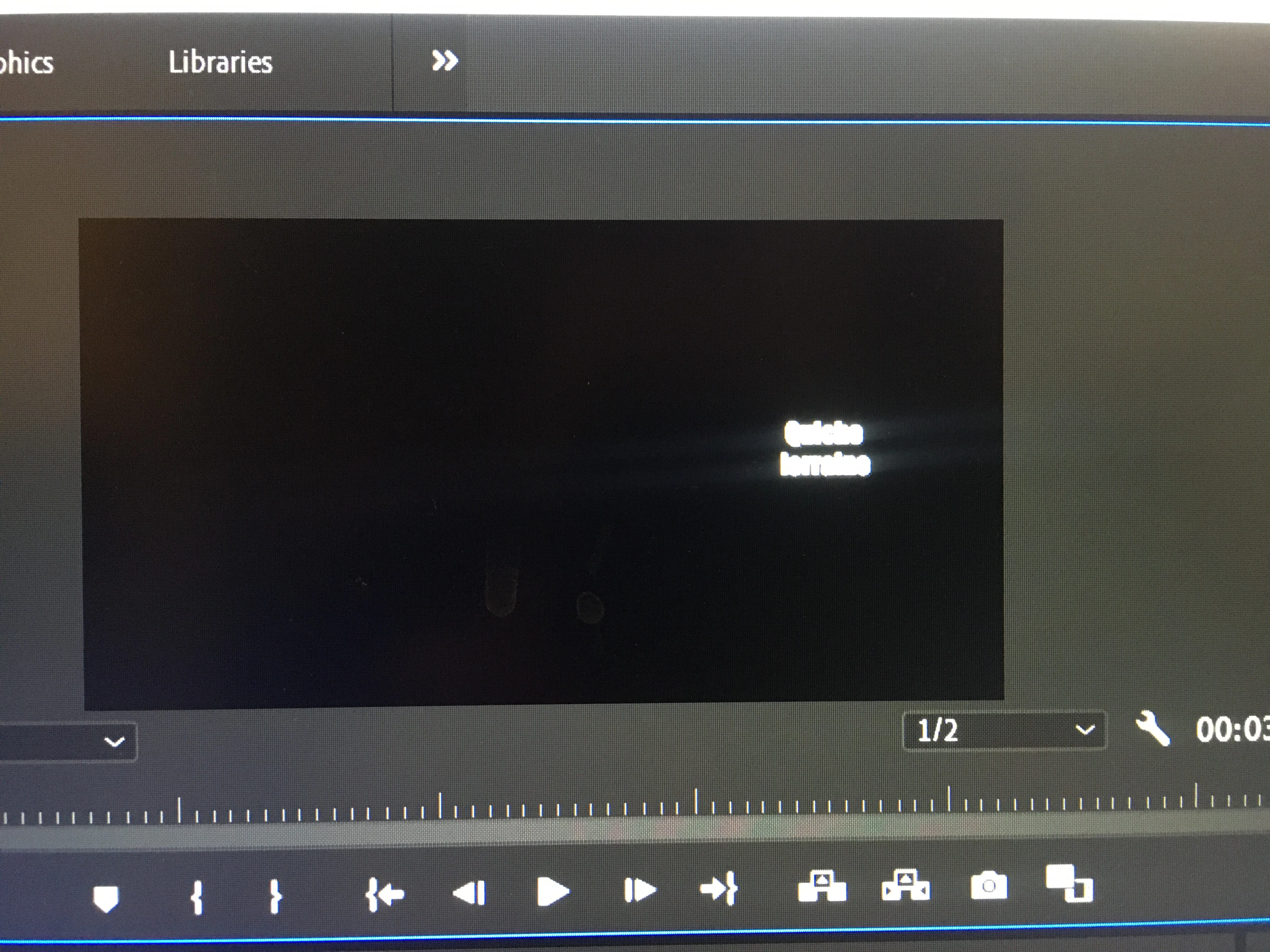

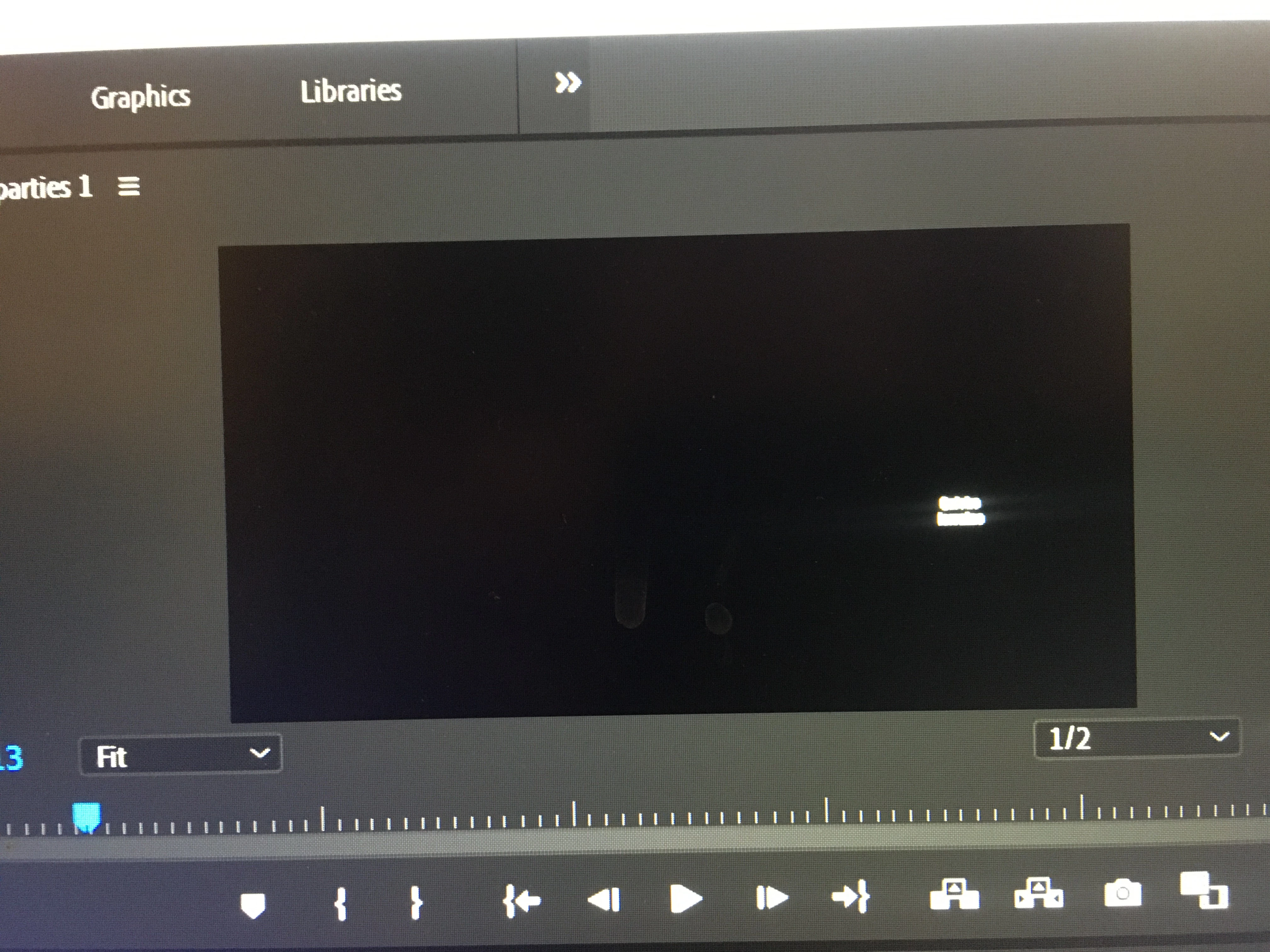

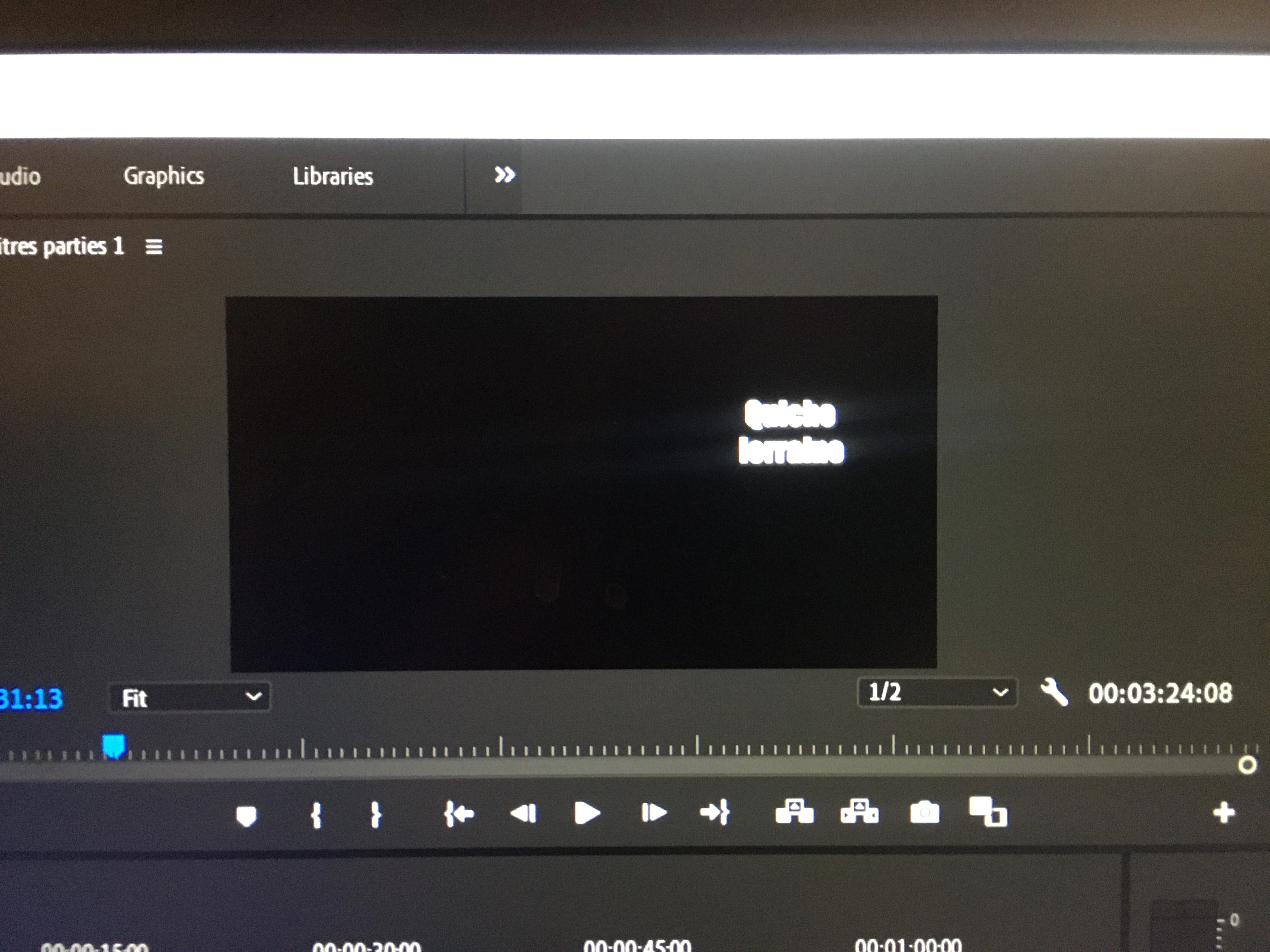

November 1, 2019
Below are 3 screenshots.
Note that, on the effect settings, I only made the scale differs, not the position or anchor point. But look  how, on the screen, the position will change. This is my problem.
1) scale = 50
2) Scale = 100
3) Scale = 150
