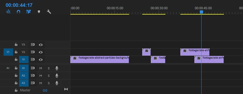

I am using the getVideoTrackAt and getItemAt methods to apply an effect to a clip. However it is only working when using the first clip on any given track. Also, the indices required seem to not be working, unless I am missing something simple. The videoTrack I am storing is working fine, but when I try to get any other item besides the first, it gives me undefined. Here is my simple project setup and code:
app.enableQE();
var clip;
var thisTrack = qe.project.getActiveSequence().getVideoTrackAt(1);
clip = thisTrack.getItemAt(0);
// gives me undefined
clip = thisTrack.getItemAt(1);
// gives me the first clip in the track
clip = thisTrack.getItemAt(2);
Correct answer Nathan Lovell_52
Thanks for your help @Bruce Bullis ! The issue was that I was confusing the vanilla and qe ways of looping through items. With the normal way of looping through all the clips in a video track, it only counts the visible clips, but with the QE way, you must also take into account the 'empty clips' between any present imported clips!
QE example of looping through each item (0->numItems-1)

Nathan Lovell_52
November 30, 2020
Right! In this case I mean to reference my V2 (second video track). On that track I have 2 clips (see above image), but the only non-undefined clip it returns is the very first 1, and in the wrong index.
getItemAt(0) should be the first clip, but it is returning undefined. getItemAt(1) is the only option working, and it returns the first clip. Furthermore getItemAt(2) returns undefined as well. Given that there are 2 clips on this track, why am I only able to access 1?
