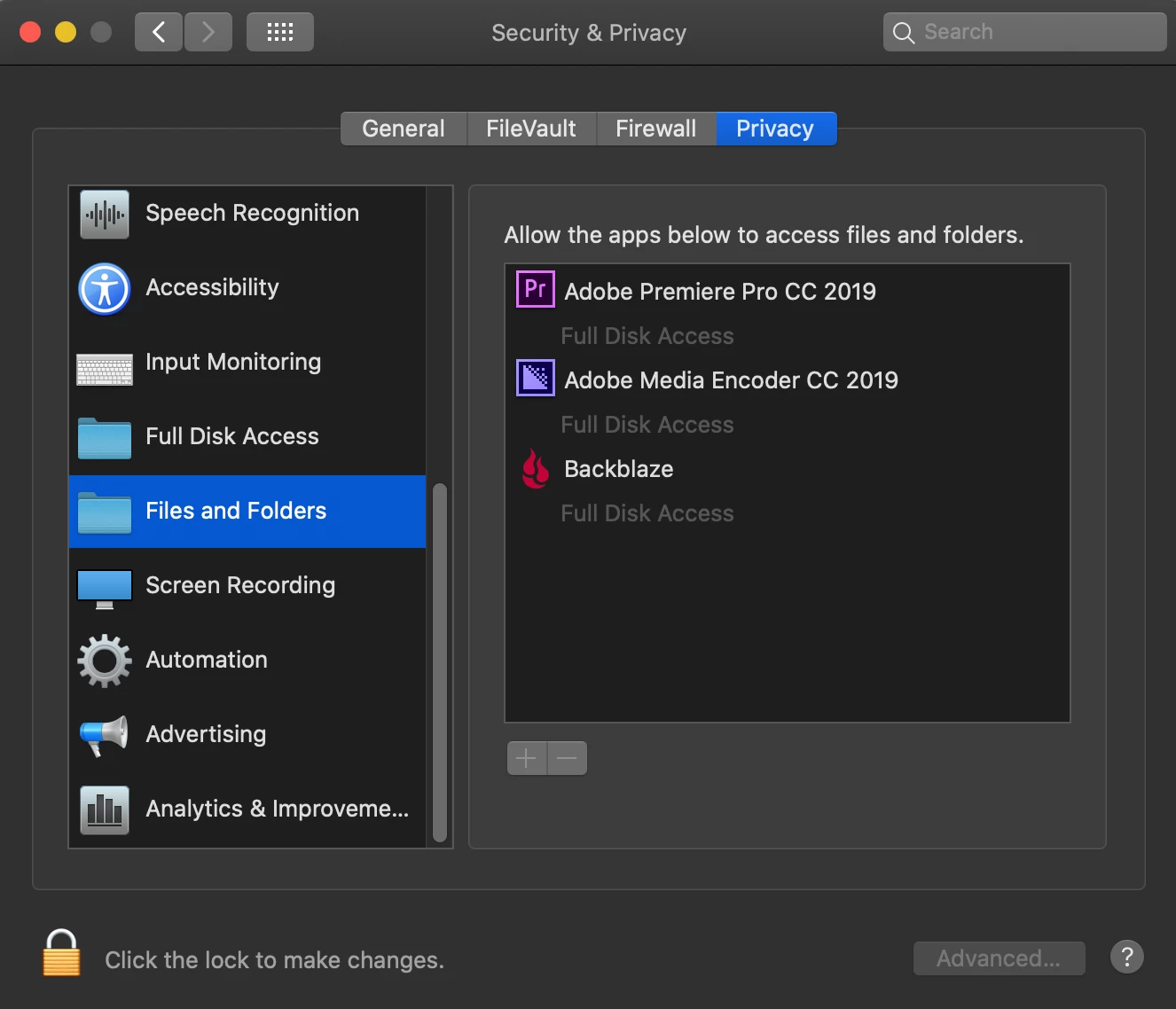

I don't have a Catalina Mac that hasn't previously been upgraded from Mojave to test this on, but it sounds like permission issues especially knowing how much things have changed in Catalina. Have you played with settings in Security and Privacy? I would try adding Premiere and Media Encoder to the "Allowed" list under Files and Folders and Full Disk Access.
chockolate
December 29, 2019
Hi WithersDigital,
Thanks for your suggestion. Have actually tried on both the MBP 16" (2019) and MBP 15" (2018) but to no avail.
