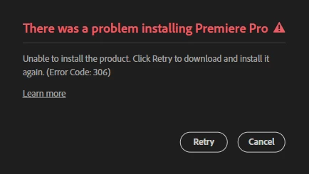

i have fixed it! i used the Creative Cloud Cleaner on the "All" function and reinstalled basically doing a completely clean reinstall, it has worked and im marking this as a answer and complete!

i have tried using adobe cc cleaner but that didnt work still have a error and its not even showing the name of the thing it errored on. heres the error code and error message after using the cloud cleaner.
