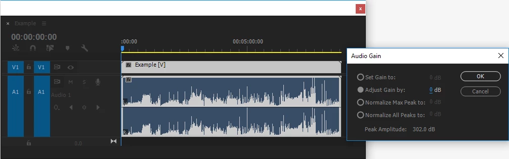

[Premiere 2017.1 BUG] Wrong Peak Amplitude / Incorrect normalize on Audio Clips
Steps to Reproduce Bug:
1. Select an audio clip or many audio clips in timeline, right-click, audio gain.
2. Peak amplitude is a non-valid value in random clips (eg. 346dB)
3. Normalize all peaks to any level
Results:
Muted clips (clips with extremely low gain, e.g. -346dB)
I already reported it. Tried on empty project with all cache manually deleted.
Anyone else having this?

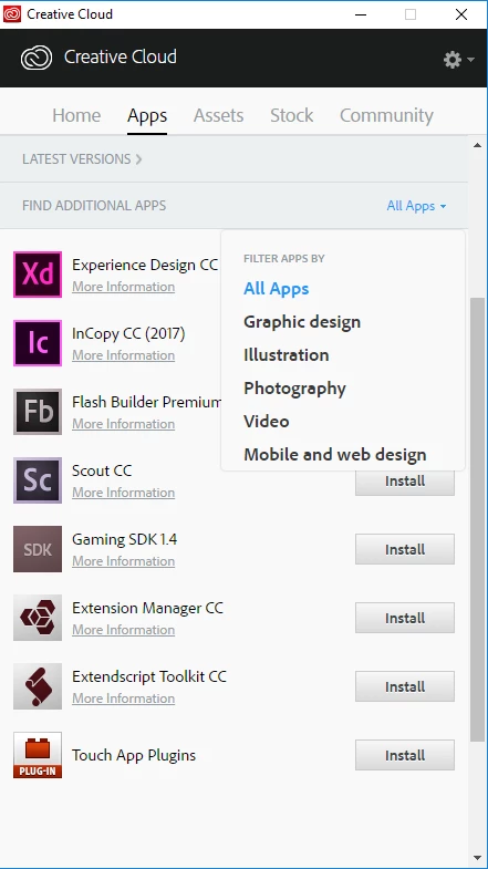

Apr 28, 2017 7:31 PM UTC
This is major issue as Audio Gain is clearly broken in Premiere Pro 2017.1 and there is no option to revert to a previous version as recommended by Adobe: https://forums.adobe.com/thread/2233693​. The latest version of Creative Cloud Version 4.0.1.188 doesn’t have a "VIEW PREVIOUS VERSIONS." option and the discussion thread is locked:
R Neil Haugen
Apr 29, 2017 12:57 AM UTC
Sign out of Creative Cloud desktop app, reboot the computer and check back in. Perhaps uninstall and then re-install if necessary. I have the same version, and yes, it does have the line below those with the 'View Previous Versions" option there.
Your CC Desktop app is not working properly.
Neil
Everyone's mileage always varies ...
Apr 29, 2017 1:06 AM UTC
Is it possible you had already installed an earlier release of Premiere Pro prior to installing 2017 e.g. CC 2015? There is no option to regress to an earlier version through Creative Cloud if the software wasn’t already installed before the upgrade. I may be wrong but it looks as though you can only go back a whole release number, not from 2017.1 to 2017. I’d be happy to be proved wrong though!
