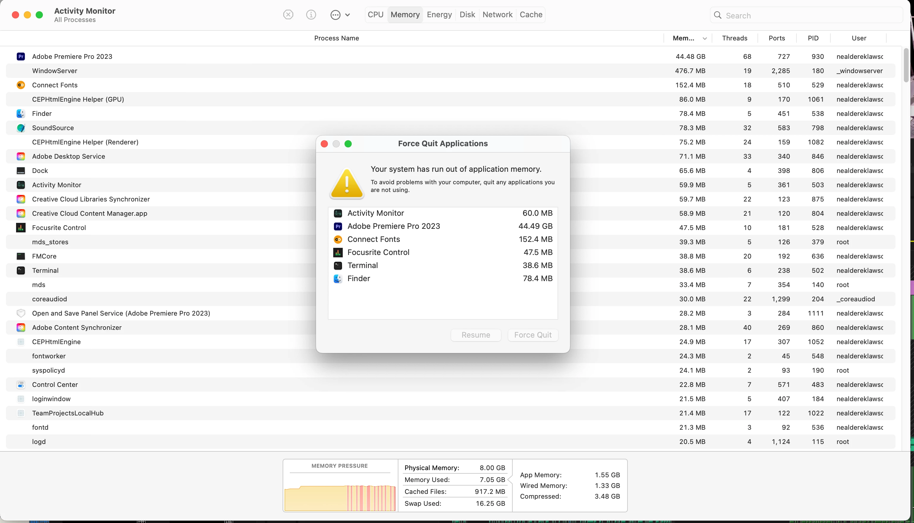

Things just keep getting progressively worst.

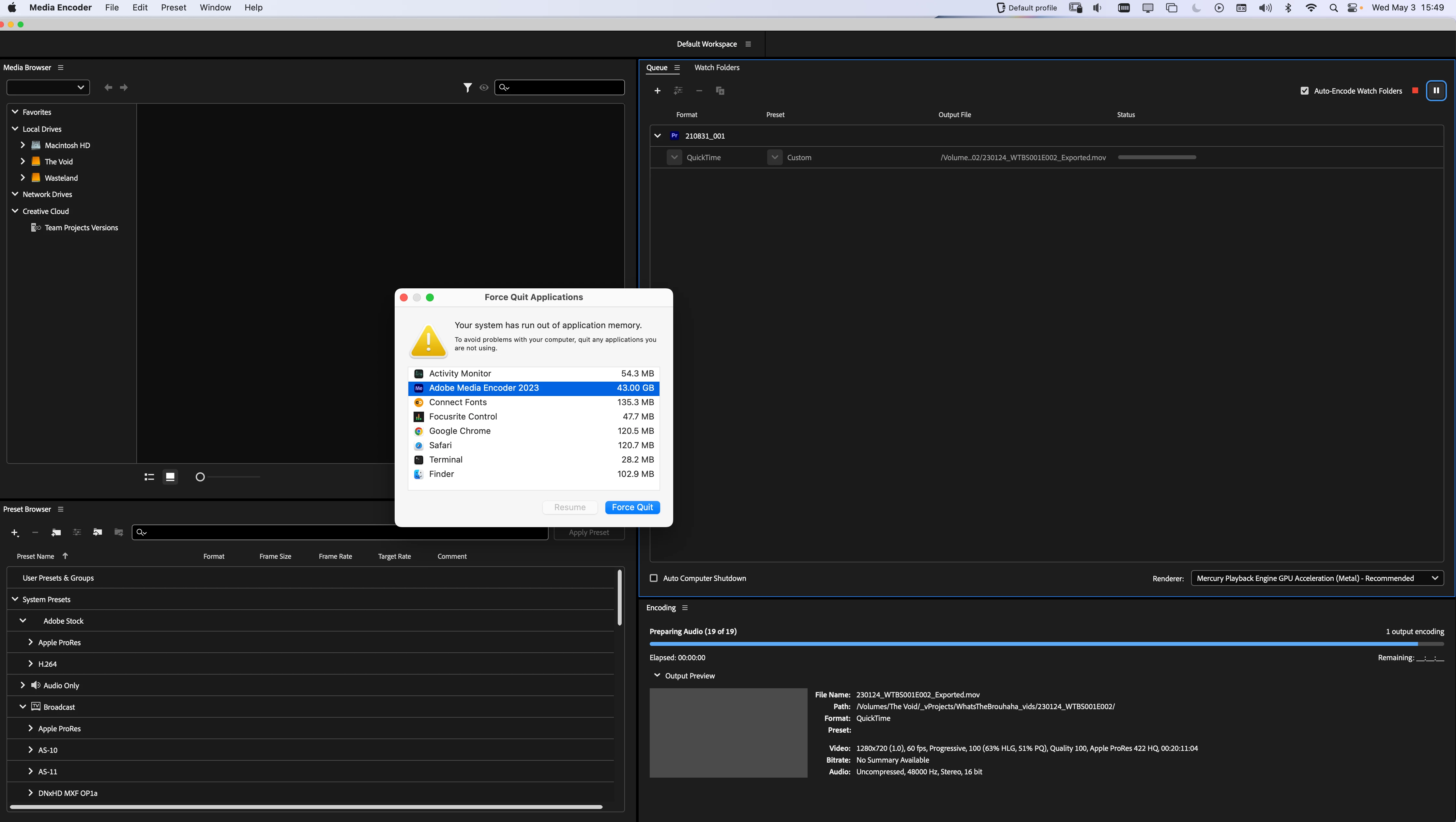

Initially, I was able to play the sequence and move the play head around, and at least attempt to export, which is when it would initially crash and "run out of application memory." Now it's crashing and "running out of application memory" even if I move the playhead at all.

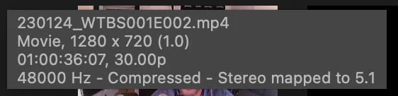

I converted my source file from .mov to .mp4, using handbrake, then I selected the .mov and used "Replace Footage..." to swap it with the .mp4 version.
I took screenshots of anything I could think of and posted below.
Previously I was able to work on and export a way larger file than this, so I don't think it's down to my 8GB of ram on my imac M1.
These issues started after I updated to Ventura 13.3 and with Premiere Pro 23.3.

Also, any .MOV files, especially ones with variable bit rates, I converted to .MP4 with a constant bit rate using handbrake
