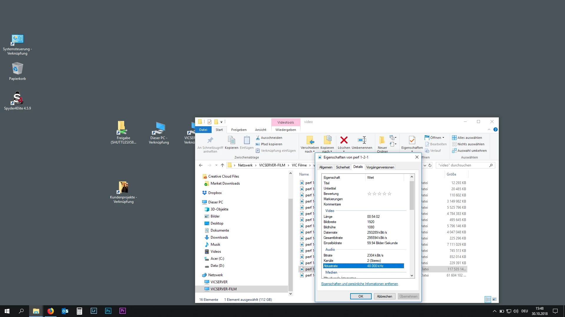

I've trashed the media cache files and preferences - same result. The files where recorded on a Blackmagic Video Assist at 1080p 60fps coming from a Canon 5DMk4.
It seems, that files from the same device but recorded at 30fps (in another project) coming from a Canon 7D Mk2 have no problems.
Yes, I could supply you with the files but they are pretty large (see screenshot below with the contents window).
October 30, 2018
Thank you for the added information. There is an open issue with ProRes and DNxHD .mov files from Blackmagic devices (such as Video Assist and Hyper Deck) that is currently under investigation. These files will work in Premiere Pro 12.1.2, but result in low-level exceptions in 13.0. A fix is being worked on.
