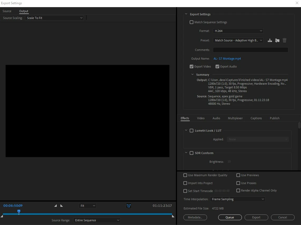

It would be very useful to see the Export dialog box ... so make a screen grab of it, then drag/drop that image onto your text reply area. As in my example below.

I get what you mean regarding establishing a timeline. I think my primary frustration is, with the other softwares I've used, I've been able to determine the type of timeline I need while creating the project. The timeline can then exist w/o media. I haven't found a way to do this in Premiere.
Regarding the screen:
The finished project is only 3-5 minutes, but the time on the left is showing over an hour of footage (the length of the first clip I dragged into the timeline). I originally thought that was just a preview of the footage in the project so I thought nothing of it, but that's what ended up exporting. The export file is the same, hour and 11 minute length.
