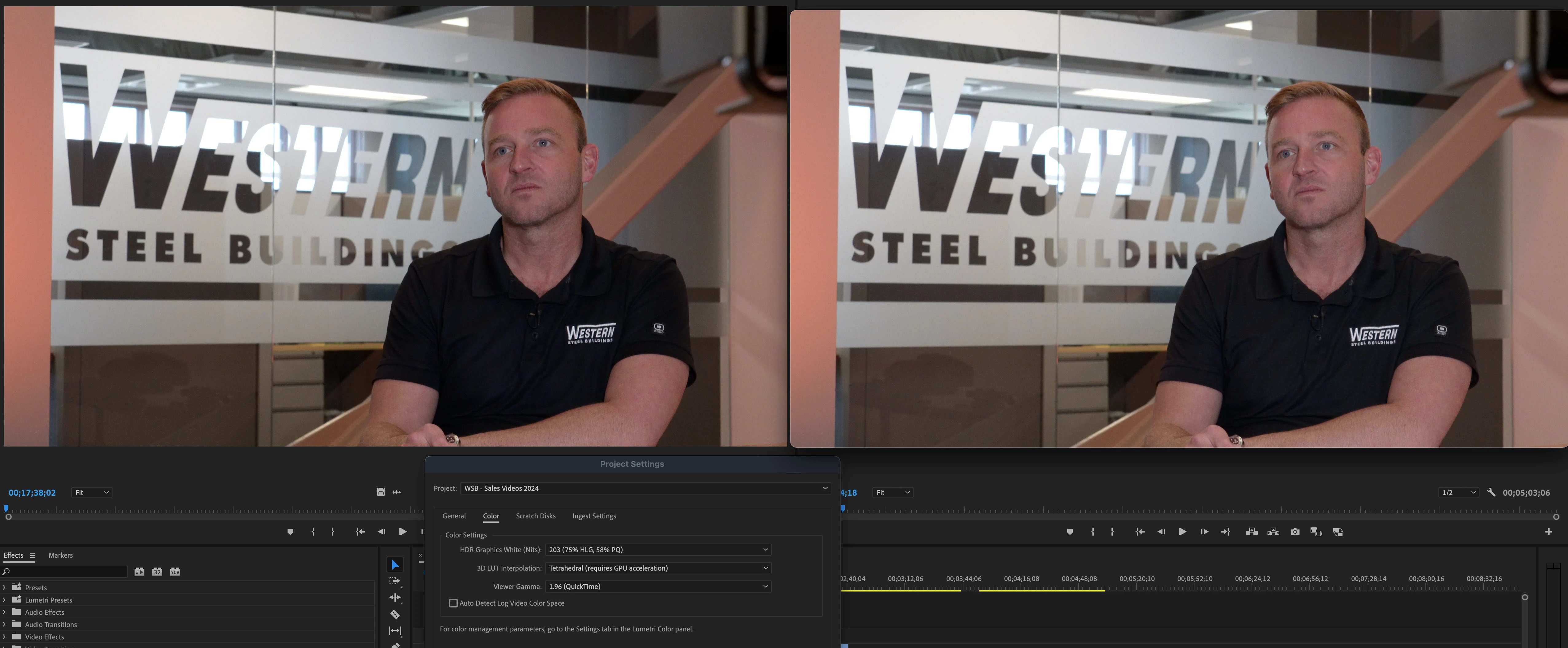

Hey, I often try to find solutions to my Premier Pro problems on YouTube. But for some reason, my YouTube quest for answers is simply not working.
I've been having this issue with the colors in Premiere Pro. A little bit of background on my setup: I use a Sony ZV1 and oftentimes an iPhone to shoot footage. The issue that I'm talking about specifically now, though, deals with the Sony ZV1 camera. I use the auto setting mainly when using this camera for video. For some reason, the colors look different for my footage when I look at it in QuickTime versus when I look at it in Premiere Pro. Everything is fine in QuickTime, but the second i drag the footage into my Premiere timeline, the colors change slightly. In Premiere Pro, the colors are darker and look a little bit off. I believe the highlights are skewed aswell. For some reason, they don't look exactly like QuickTime. This forces me to color-correct every single time, and it's quite irritating. I just want my footage to look like it does in QuickTime. Other editing software, like Final Cut, doesn't give me this issue. I have tried everything under the sun, from changing color spaces to turning on color management. Nothing seems to solve the problem.
Do any of you know how to solve this problem? The colors are just off, man. If you can help me solve the problem, it will be greatly appreciated.
In this screenshot attached, the left is what the video looks like in quicktime. On the right is what the video looks like on my premiere timeline.

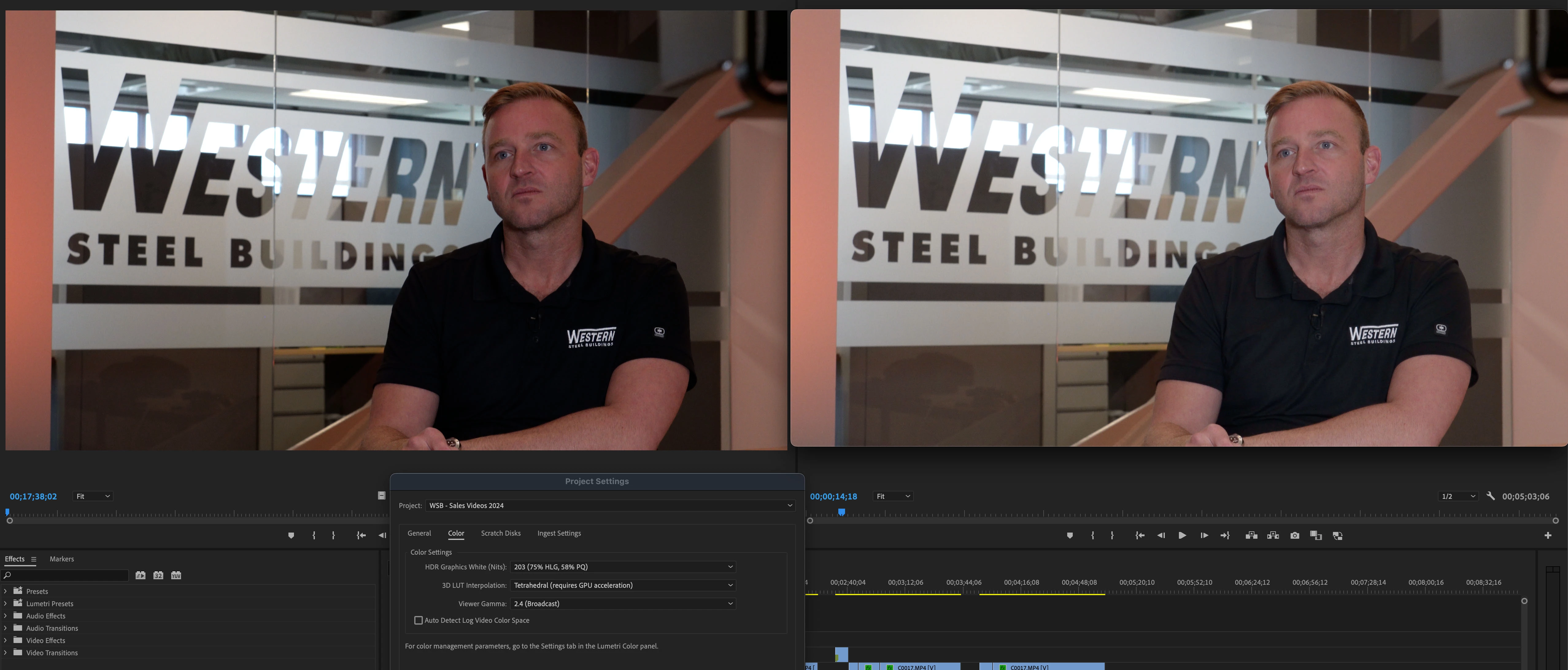

• Change your Viewer Gamma to 1.96 Quicktime, 2.2 Web or 2.4 Broadcast.
BUT, I have now tested all three of these settings in this same project and the color of the footage does not change at all if the "Display Color Management" is turned off.
2.4 Broadcast - Left is Premier and right is what I see on the camera and Quicktime/VLC viewer

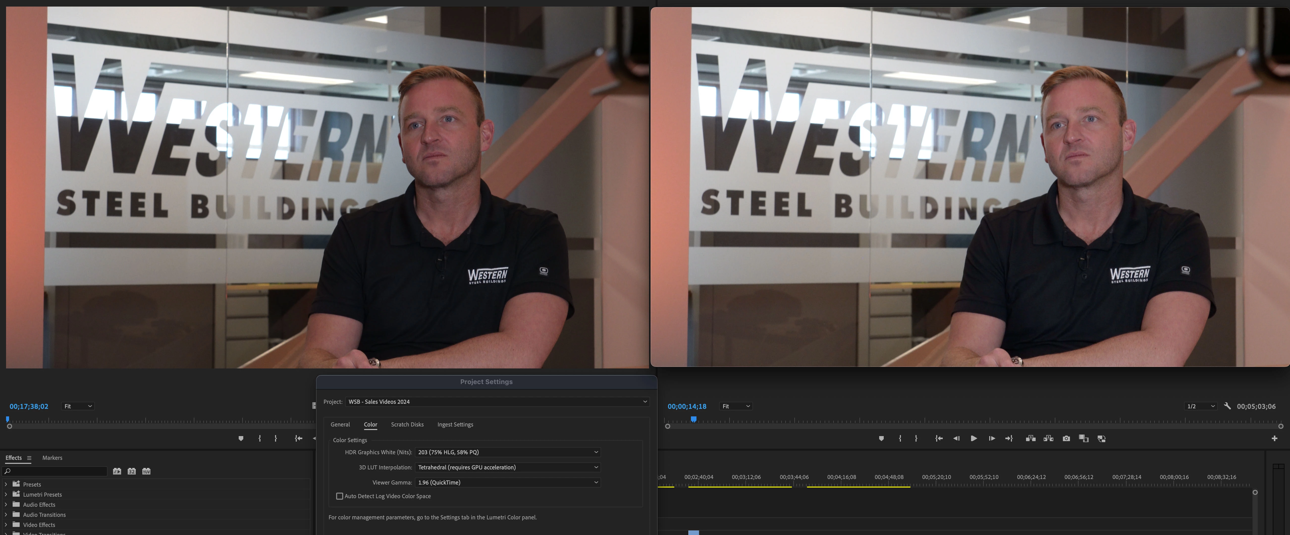

1.96 Quicktime - Left is Premier and right is what I see on the camera and Quicktime/VLC viewer

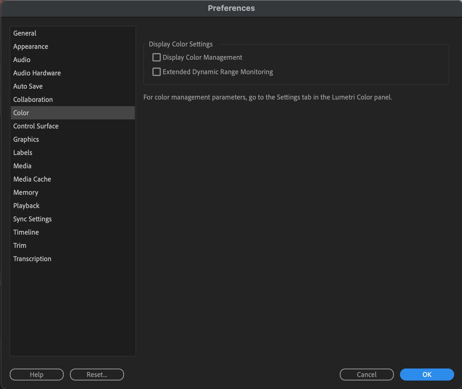

 If I turn on "Display Color Management" and "Extended Dynamic Range Monitoring" under the Preferences / Color area, the color changes.  But NOT in a good or accurate way at all.
1.96 Quicktime is closer to what I see on the camera and my color-accurate display monitors on set, but it is still not fully accurate to what I should be seeing from the file and when compared to numerous other preview programs outside of Premier. It is still a bit darker and definitely more saturated.
2.4 Broadcast is completely wrong in terms of what I see on my camera. If I had to shoot my footage to get it to look correct on these settings in Premier, the shot would be nearly blown out while on set... not that I would have any way to adjust my color space to match these dark and over-saturated settings while on set. This can not be acceptable for Premier editing. This is just plain nuts and I can't believe that Premier considers this acceptable!

 I have tried to adjust the color settings.  I am only seeing the two checkboxes under Preferences-Color and if I check these boxes the color gets WAY worse:
Can you please tell me where these other settings are that you are saying can be changed to fix the issue with Premier and their new color space?
