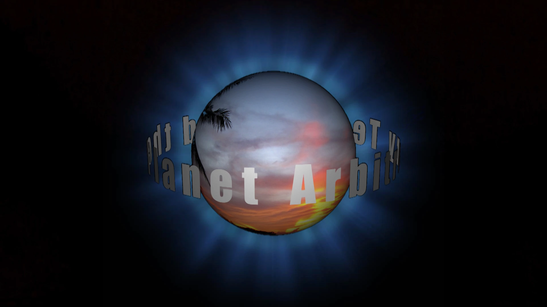

Composite with Alpha:

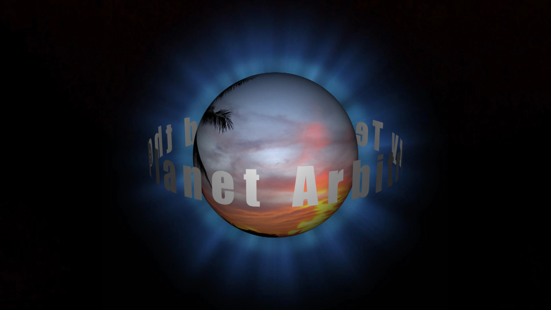

Composite with the above Luma Matte:
