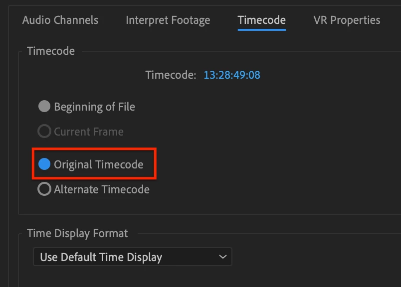

Adobe Employee
August 26, 2022
Hi ckbknyc,
We're sorry to hear about this. Please try these steps & check if it's working properly.
  • Right-click on the media in the Project panel & select Modify > Timecode
  • If the Timecode is set to Alternate Timecode, switch it to Original Timecode
Let us know if it helps.
Sumeet
Markus Scheibenbauer
November 15, 2022
Hello Adobe, no that doesnt fix the problem. The Original Timecode is set to 00:00:00:00 by default. I tried different methods importing FX3-Footage. I tried the new import tab, the media browser and the drag and drop method. the timecode is always set to 00. It doesnt have to do anything with the adapter since i dont't use it. Premiere seems to be unable to read the tc of the fx3 properly... I'm on a mac. Premiere Version 23.0.0 (Build 63). If I import the same clips into LTCconvert or Tentacle Sync Studio, both read the timecode just fine. It has to be a bug of the new version since I used timecode syncing on premiere before with my fx3. thanks for your help
