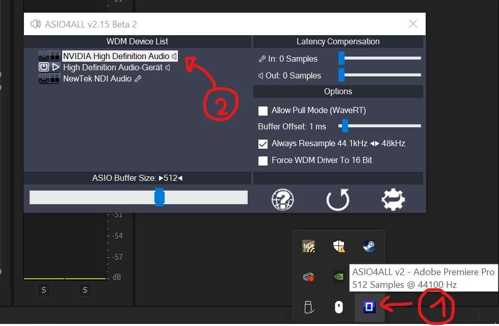

Thanks a lot that worked for me but only after i used this "asio-wraper" > ASIO4All (https://www.asio4all.org/).
Please read about what ASIO4ALL does!
Maybe not the best solution but nothing else worked.
  1. Install the .exe file and restart the PC
  2. Start Premiere and got to Edit > DefaultSettings > Audio devices > Choose ASIO for
  3. As soon as playback is started a notification will pop up from the ASIO4ALL software
  4. If no sound is played back to to the taskbar (hidden applications) and double click the now visible ASIO4ALL Icon (only visible when Audio is played via Premiere)
    1. Now you have your different audo devices try and find the right audioutput
That's it - and it worked on 2 PCs (Win10)
Thanks for your help and I hope this helps others!

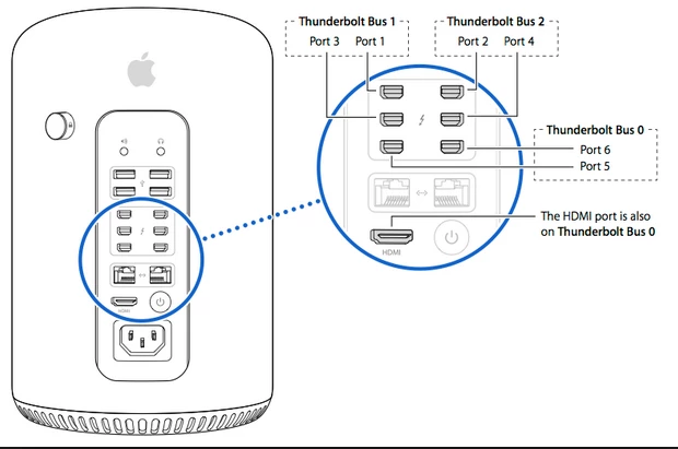

An email notification about this thread landed in my inbox today (I may have long ago marked that "I have this problem, too") and I may have some information about alleviating the playback issues.  I use AJA as my vendor for connecting video peripherals, like a monitor, and they sent me this diagram about the thunderbolt bus layout of the cylinder-style Mac Pro.
This is what AJA had to say about using this diagram:  Try to isolate thunderbolt devices on their own thunderbolt bus, whenever possible.  While Daisy Chaining is theoretically easily feasible with thunderbolt, in practice, it can negatively affect the PCIe performance of the devices in the chain.
I was also told to put displays on a separate TB bus and I did that onto Bus 0.  Then I daisy-chained my 2 Tunderbolt RAIDs (no other choice really) and plugged them into Bus 2 and plugged my AJA I/O device into Bus 1.  My playback issues are mostly eliminated now, with 4k always needing a little more nursing, like reducing the playback resolution (I noticed that the playback rez in the video example was always set to full).
Take care of rationing your computer's resources and then go from there. If you're not using this MacPro type, maybe Apple will tell you how your Mac's resources are mapped out.
