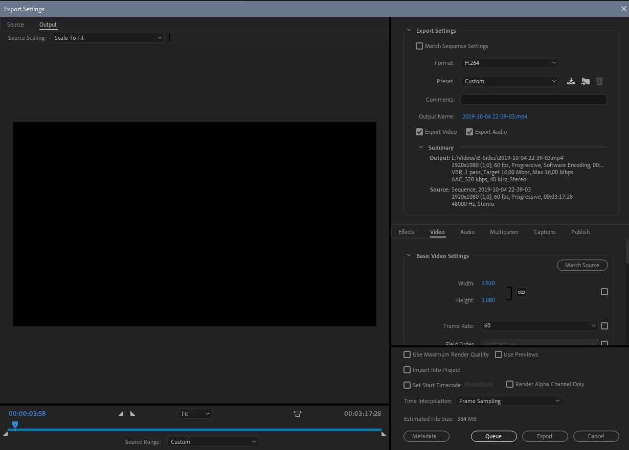

Hello guys! I've beeon using premiere pro for a few days now to edit some video game gameplay of me and my friend. Basically I'm filming with OBS Studio, NVENC, CQP (QC Level: 21) and my file sizes are already big after recording for a few hours. I figured that when I import them into Premiere they will get smaller since I trim away like 98% of one video at a time anyways. So far I've imported 2 videos that reach 23GB altogether into Premiere, cut them and applied effects of my choice.

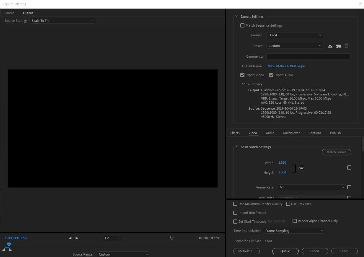

The problem now is that there is a total of 4 SECONDS of gameplay that I wanted to render with the applied effects and according to Premiere they take 7MB and 1:30 Min to render. Now I cant imagine how long it'll take me to render a bigger video and how big the file size will be. Now if I try to render 3 min out of that whole sequence I made which is pure black with a song playing in the background after those 4 seconds of gameplay, it takes 380MB (I've uploaded some screenshots of the export settings). What can I do to speed up the rendering process and make the file size smaller?

    Using the In and Out markers and the Render In to Out function took me three minutes and five seconds for those 36 seconds of gameplay. Im aiming for the smallest file size I can go without losing too much quality of the video. Also I've seen that by changing from Youtube 1080p Full HD Format to Match Source - High Bitrate makes the total file size 242MB instead of 384, should I use this one or stick to the YouTube format?

    It's not entirely unexpected that the file size hasn't grown. Your VBR is set to a Target of 16Mpbs, with a Max of 16Mbps, so coming out the other side with something in the same ballpark isn't super-strange. If it were 2-pass, with a different target and maximum, and you still came out with the exact same size, that would be odd.
    As a general rule, I've never found any value in running VBR with Target and Maximum matching - at that point I would probably just switch over to CBR. Matching bitrates tend to defeat the purpose of the VBR setting, but that's a whole other story. 😛
    Try out the suggestions from my previous post (lower the target, etc), and let me know how you get on.
