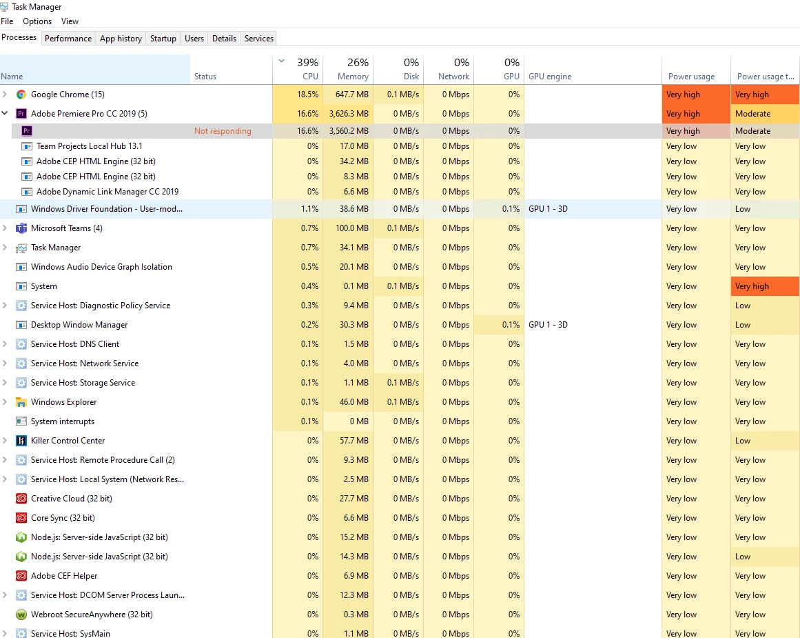

Recently I have been having a troublesome issue with Premiere Pro 2019 and was hoping to get some help. Without any reason I can find, in the middle of editing, Premiere will suddenly stop playing back any video. Occasionally audio will continue but that soon stops as well.  When this happens, within a matter of seconds, my RAM usage will basically sky rocket and max out my computer, going from 8 GB to around 55GB+ (see screenshot). At this point, I can only very slowly navigate the interface and save the project, still with no playback or frame updates when dragging or attempting to move the playhead. Usually, however, if I try to do anything, the program will crash. Strangely, if I leave my computer idle, after 10-20 minutes, playback may suddenly resume and RAM usage quickly drops to normal as if nothing happened. I can continue working at that point until it happens again. Sometimes I can get 2 or 3 hours of work, sometimes only 5 minutes, until the issue returns. I am not doing anything complex at this point. So far, I've just been importing footage, cutting and nesting different takes, and putting a few multicam sequences together. As such, I've mostly noticed this issue simply when playing through source material.
I tried doing several steps to fix this already all with no luck. I deleted my unused media cache in the preferences menu. I reset all preferences. I turned off GPU acceleration. I made sure I had the latest driver for my GPU. I imported my project into a new project. Closed unused programs. Restarted my computer. Uninstalled and redownloaded Premiere. Etc. Still no solution.  This is my first project with Premiere 2019 but it is also my first time using my new machine. I was concerned it might be an issue from my video footage (.MOV files with h.264 compression from my Canon 80D) but I didn't experience this problem before on a different machine with Premiere 2018.
Does anyone have any idea what the issue might be? Is it a bug in Premier? I am especially concerned as this is my first time on my custom build and was unsure if this may be a hardware related issue (although this only happens in Premiere, so I find it unlikely that my computer is at fault).

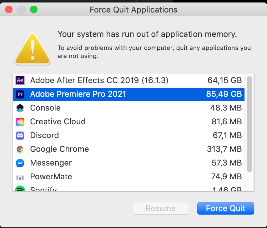

My Adobe premiere auto-updated again to 2021 and the hell started again, RAM starts filling up completely after a while... with the most basic projects.. Will revert again to older version but Adobe should really solve this issue... Same problem when using latest media encoder and AE.

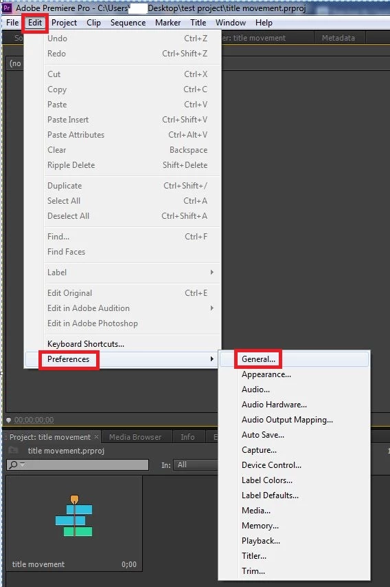

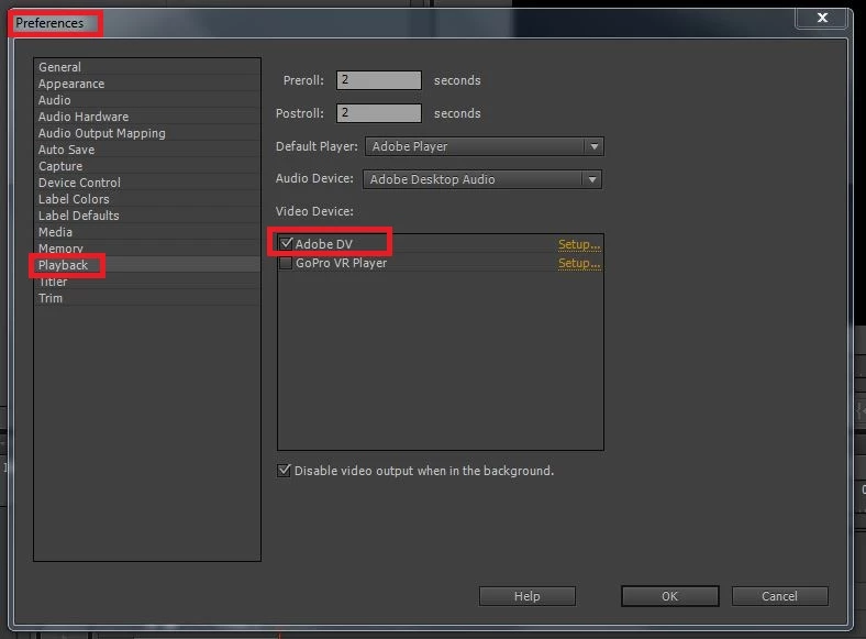

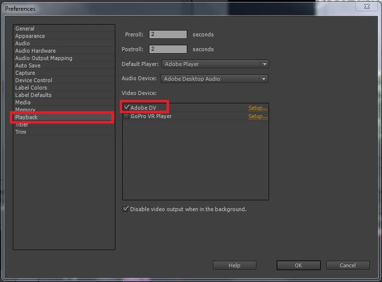

I am using Adobe Premiere Pro CS6 but I think the solution applies to the CC versions as well. I think the problem might be the default video playback is changed from Adobe DV to whichever new video editing program you might have installed. In my case.. Premiere was working smooth as butter, till I installed GoPro Studio Pro software to try and get their video codec for transparent video creation. This automatically changed my default video Playback from Adobe DV to GoPro VR Player.
When I changed it back to Adobe DV.. its back to normal and memory is well within the given range.

Can you try the following and see if this will help you. Choose the Adobe DV in the Video Device

Hey there, I am not sure if you found a solution or not. But I am also facing the same issue. I just purchased an iMac 2019 and it arrived this wee. It is a substantial investment for me to be able to edit and work from home since I don't have access to my university's suits during the pandemic.
This is exactly what happens: When rendering a 50-minute film, which is only HD footage, the Activity Monitor shows that the premiere suddenly shoots up the memory usage.  All of a sudden from using 6-7 GB it goes all the way to 20, then 40, and then to 60GB, at which point the computer gives the message "there is not enough application memory."!
I have to force quit premiere and repeat the process which so far has resulted in no success.
This iMac is brand new; it has a 3.6 8- core 1-9 processor, Radeon Pro Vega GPU, and 1TB SSD Storage, and 8GB RAM. I invested in the CPU and GPU and decided to upgrade the RAM later to 32 GB. I am in shock about this and very stressed, to be honest. The storage is basically empty as I always work from Hard Drives and since it is brand new I literally have nothing on the desktop yet.
Is this a premiere problem or the new macOS?

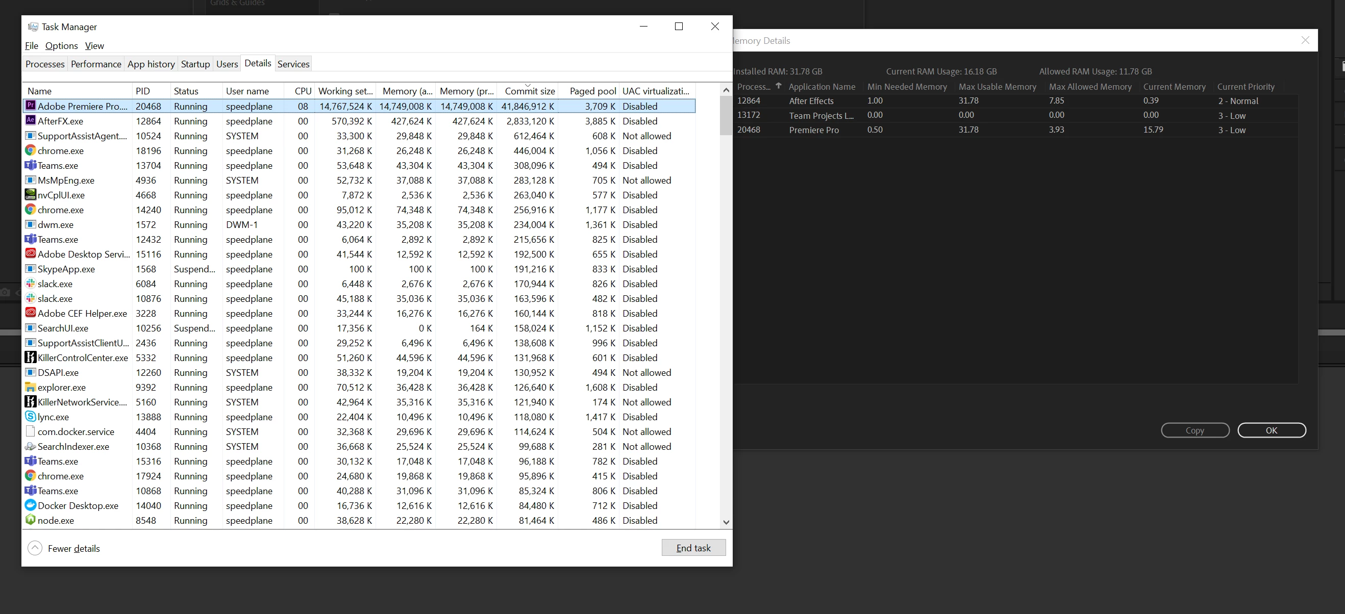

October 18, 2019

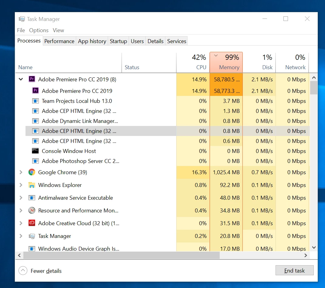

Hi everyone,
Also suffering from the issue of playback freezing in an unfounded time of editing. Ususally right at the beginning, shortly after media file import.
My system:
i7-7700HQ
32GB RAM
GTX 1080Ti
The RAM maxes out at 99% and says is using 16GB. The screenshot below has been captured mid Pr crash.
The system does recover eventually but then just crashes again. I updated my gfx drivers and previously have been able to edit without troubles this week though that was not using footage.
Media encoder struggles to transcode my footage too which I've tried. After effects seems to be ok. Other adobe apps seem fine, not using video footage with them.
So, I assume the video footage is the problem but I don't see why my laptop can't handle the footage. It's Canon MP4 4k 25p 119Mbps.
I have tried disabling adobe fonts, as I saw someone say that worked. Hasn't worked for me though.
In short, video footage on Pr crashing. Machine is powerful enough to run the footage.
Any help, really appreciated, I can't work on simple tasks and the IT department have run out of ideas as they aren't adobe experts.
