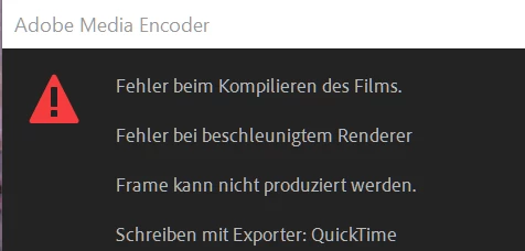

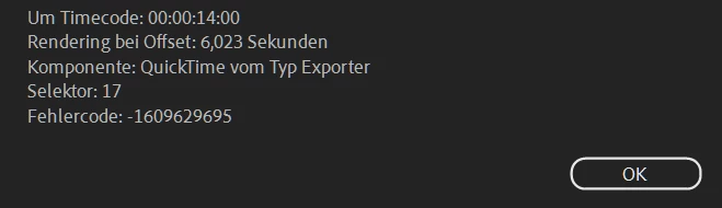

it's not possible to export sequences from Premiere Pro.
It doesn't matter which export format.
Happens with Sony raw footage, which plays without any problems inside Premiere
It's possible to export from Aftereffects on Windows and also from Premiere on a Mac.
Tried already with deactivating accelerated rendering etc. without any success.
Please help
"Failure at compilation
failure at accelerated rendering
frame couldn't be reproduced"
No matter if "h264", "tiff" or "mov"...

What is on the timeline around the timecode listed?
In case you're using some effects try placing all effects on an adjustment layer at that point in time. Please also try the following:
