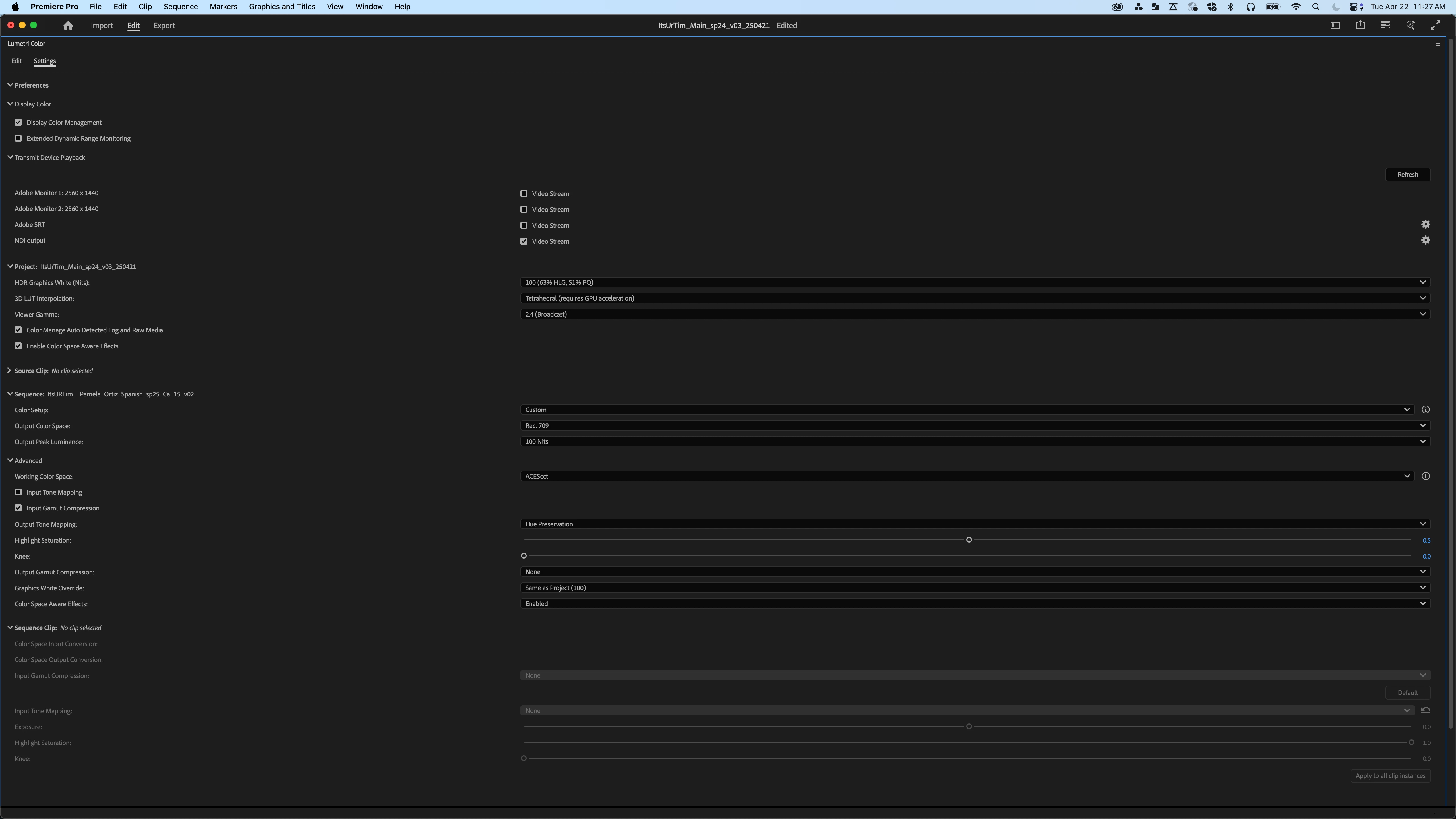

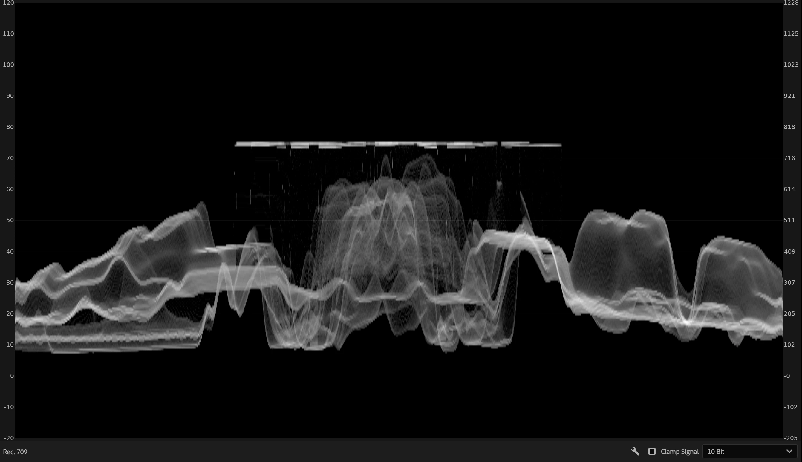

I'm using the updated Color Managment tools in Lumetri and I can't get the white text to be white in my project. I've tried the settings to overriding the color space and nothing I change effects the luminance of the white text. The graphics and captions are showing about 75 IRE no matter what I do.
Current Premiere Pro Version - 25.2.1
Mac OS Sequoia - 15.3.2

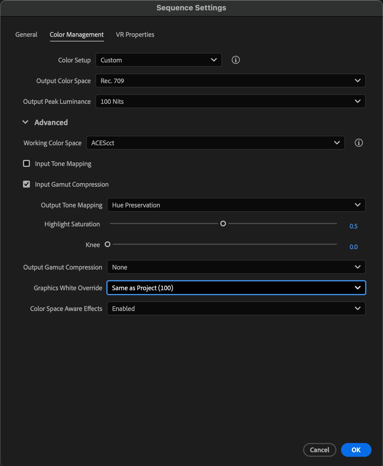

Welcome to the community! Under Sequence Settings > Color Management > Advanced, set Output Tone Mapping to None. Hope it helps.

Changing the" Output Tone Mapping to None" does solve the problem of the graphics not displaying correctly, but now my footage is blown out and not correctly colored. I hoped the "Graphics White Override" would take care of this, but it's not having any effect.

If you are using media files with wider color space in the same SDR sequence, you may try Input Tone mapping for clip-specific adjustments. For this, you can set Sequence > Color Setup to Direct Rec. 709 (SDR). This should change Output Color Space & Working Color Space to Rec.709 & enable default Input Tone mapping. If required, you can then select the HDR clip in the timeline & make clip-specific adjustments to Input Tone Mapping under Lumetri Color panel > Settings > Sequence Clip. Let us know if it helps.
