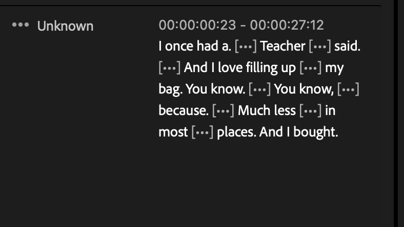

Premiere Pro 25.5 Transcription Issue - From great to REALLY bad
Anyone having issues with 25.5 and transcribing?
I've been using the transcription tool for years. It's been nearly flawless for me for 18-24 months except for one update that was fixed quickly.
Essentially, the transcription tool is "shitting the bed".  I have several 6-10 minute interviews and the transcript is missing 99% of the interview. Showing elipses that sometimes span :10s+.
Audio is fine on the clips. All English speaking Americans. I've done nothing different from what I've done the last 4+ years.
Anyone else having issues? I'm about to uninstall/reinstall as reseting prefs has not worked.

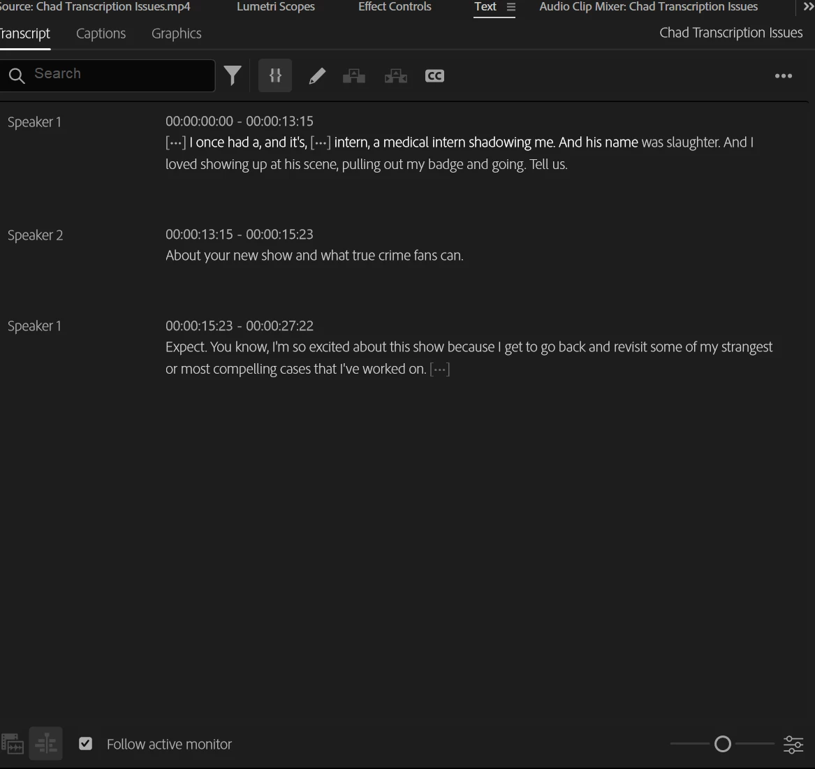

@Chad22158382h0cg,
The sample clip appeared to have phase cancellation - it showed "No dialogue." I just extracted mono and used one channel. I don't think that's your issue, because what you get is an empty transcription - not a bad one. I tested in Beta 25.6.0.74, and when all was well, also tested in Release 25.5.0. My sample below.
I'll also note that I have a couple clips I use frequently for testing, and neither of them (nor any other transcriptions) have shown the dramatically bad accuracy you are seeing.

Sep 26, 2025 4:13 PM UTC
Phase cancelation? Hmmm.... odd. It was just a on mic-set up on this (I just used one lav on each talent). Same setup I've been using for years. Audio straight to camera. Output at .mp4 out to SD card.
I will say after I posted this I tried transcribing a simple VO .mp3... and it worked perfectly. So it does appear to be these clips. But again, I'm sure what is different here... same video/audio capture that I've been doing for quite some time.

Sep 23, 2025 6:17 PM UTC
Sure... here's a trimmed and edited clip. I also have a screen shot of the "transcription"... and you can see that it's barely catching anything.
