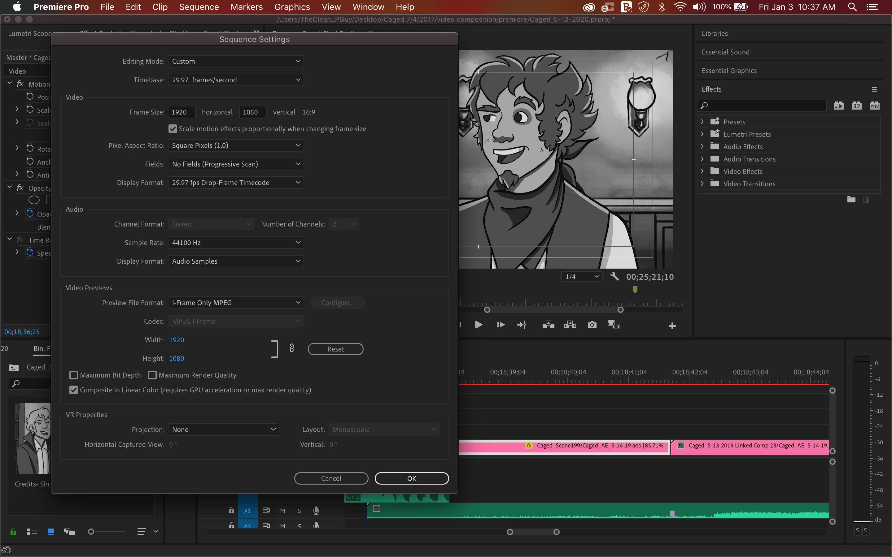

what are your sequence settings inside Premiere Pro? If you are on a 1080 sequence and dynamically linking
to a comp that you changed or pre-composed to 4k inside After Effects then that might be the issue...
Premiere Pro sequence settings and After Effects composition settings should match.
Are any of your dynamically linked premiere proclips nested as pre-comps
inside after effects then inserted in a 4K comp?
I can't really sort out your workflow, can you please share screenshots or a recorded screen grab on what
you are doing exactly? Also, what are your export settings and preset in AME?

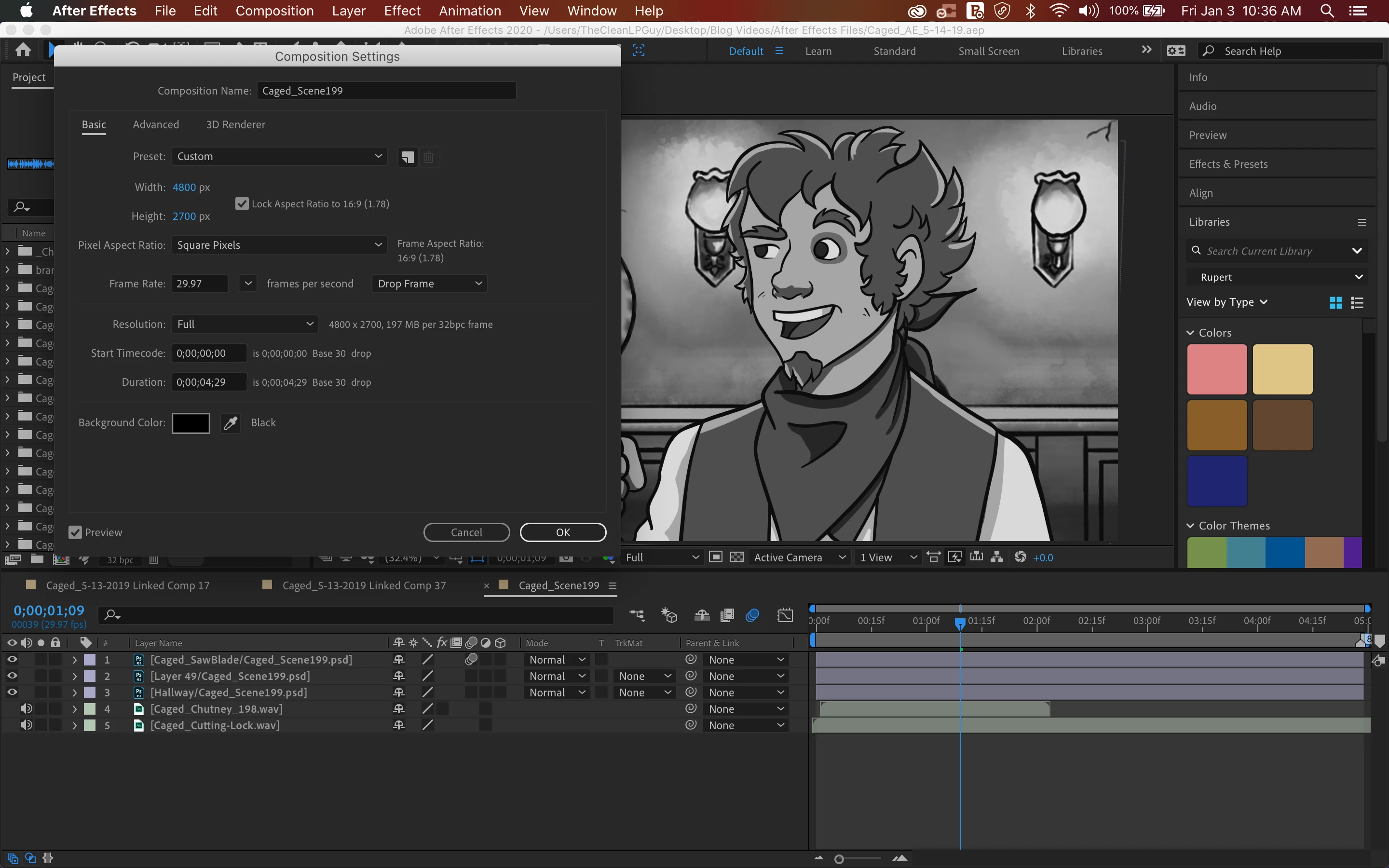

The first screen shot is from AE, now the frame size is 4800x2700 and that is what the PP Sequence was before we brought it down to 1080p.
This is PP, the frame size is reflective of the current change, 1080p. But all compositions made at the size of 4800x2700 were linked when PP was still 4800x2700. They have been scaled 40% to fit the frame size of 1080p.

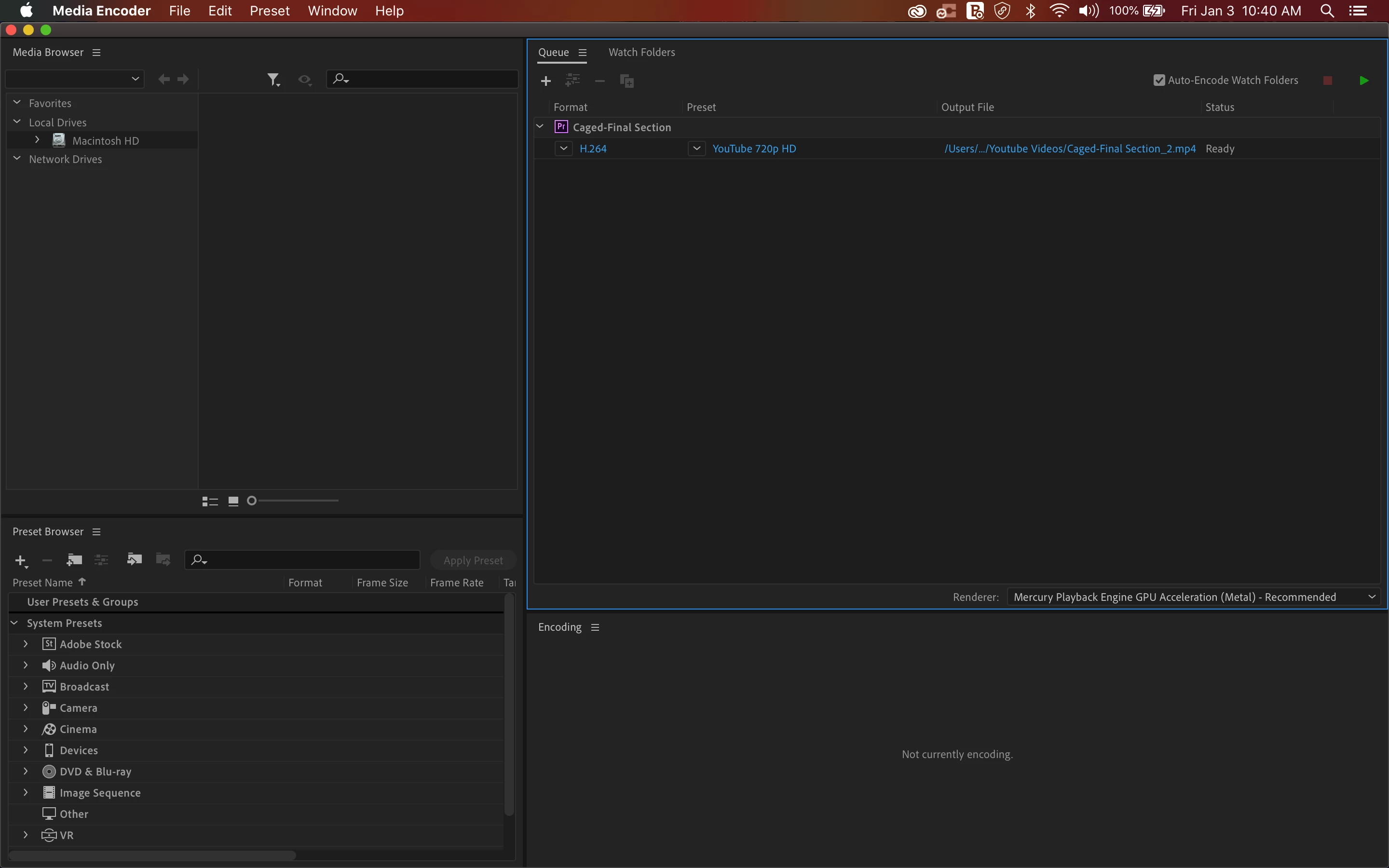

This is ME. We are exporting it in 720p because most of our previous YouTube videos are 720p and we wanted to keep them close to the same resolution.

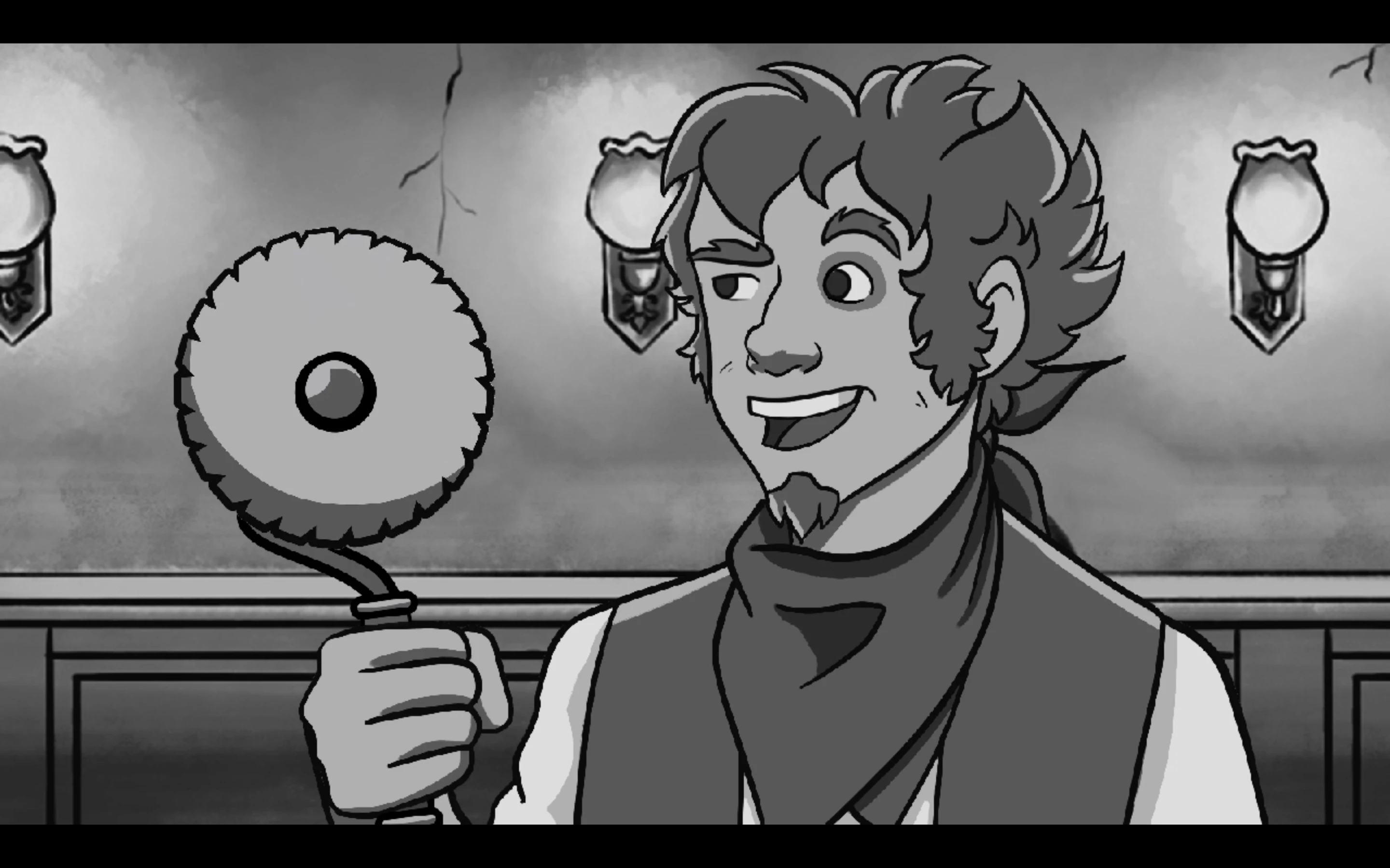

This is the final export of the same AE comp. As you can hopefully see the line art of the character and in the background are jagged.
