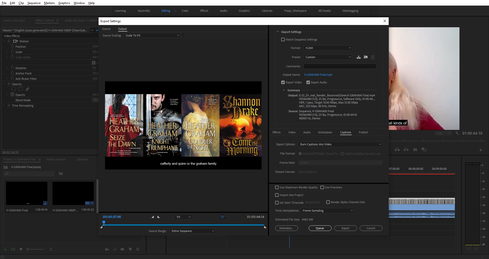

I can only see burn in export setting no Sidecar option.
Is it because the captions are in open captions format.
I did not made any changes to caption format no text font changes or anything else.
Well, my apologies. And thank you for persisting and continuing to tell me the export as sidecar is not there in the Export -> Media dialogue.
I checked my notes and realize now that that option for Open Captions was not added until the 2020 version.
I just checked in 2019 (I do not have 2018 installed any longer). In that version, and I believe 2018 also, you can export Open Captions to a sidecar by selecting the SEQUENCE in the PROJECT PANEL and then File -> Export -> Captions. The timecodes should then match what you have in the sequence.
Let us know.
Stan

Thank you so much for the information.
Should I try Premiere Pro CC 2021 version and then export my files.
I want sidecar file to export with my video.
Stan Jones
October 2, 2021
First, just export from PR 2018. There is no reason you shouldn't be able to. Try the srt export. Are you certain that you do not see sidecar as an option when you click on the dropdown that says "burn in" currently? If not, I'll describe another method for the export.
And if you can finish this project, you limit any issues if there is a PR 2021 bug that is a problem on your system.
Second, when you do update, be sure to keep PR 2018. If you allow the update to remove it, you may be unable to reinstall it. There are many improvements, so you just definitely give it a try.
Stan

October 1, 2021
Hey Caroline,
Thank you so much for the video link this will surely help me.
I do have .SRT files for all the episodes/videos but when I am rendering the final export there are no options as Sidecar file or Embedded.
There is only one option burn captions into video which you can see in attachment.
caroline_edits
October 1, 2021
I wonder if you have any customizations made to your captions styles? Did you stylize the text of the captions with the Essential Graphics panel? .SRT files have to follow strict guidelines on what fonts and styles it can use. Try changing your text to something boring like Times New Roman and remove any other customizations.
Thank you for the screenshot so I can tell what you mean! I do not actually see a captions track in your timeline. Could you minimize the export settings window and send a screenshot of your timeline?
Thanks! Let us know.

October 1, 2021
Thanks a lot Sumeet.
Your reply will surely help.
Could you Please let me know if the video captions are open captions can we get it exported in Sidecar file and Embedded because when I am exporting the video file with caption there is only one render setting in captions I can see.
Please refer to the attachment.
