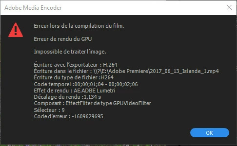

i'm having an error when I try to export a video in CUDA mode.
If I'm not in CUDA it's ok but the export is very long.
Somebody has a solution for that error ?
I have a Geforce GTX 570, driver are up to date.
AMD Ryzen 1800X
32Gb DDR4
Tried with H264 / Quicktime.
Empty my media cache.
But I've still the problem.
Thank you.

    I had all these problems with GTX 570 , Windows 10 and Lumetri Effects.
    To-day Nvidia published a new driver 390.77.
    All my problems are over.

    I struggled with this and tried rendering using software only instead of the card. That worked once but then stopped working. Then I noticed that the section giving me the problem has lumetri on it twice. One with a lut and one that was empty. Removed the extra lumetri and then it started to work. Have just completed first pass on the max settings throught he cuda cores. Seems to be fine.

    I've tried to remove the Lumetri photo effect (Kodac) and I don't have the problem.
    I've tried to export in Quicktime but the problem is still there.
    My 570 GTX is too old ?
    Thank you.

    I found that updating my 560 Ti to a 960 did help with this issue.
