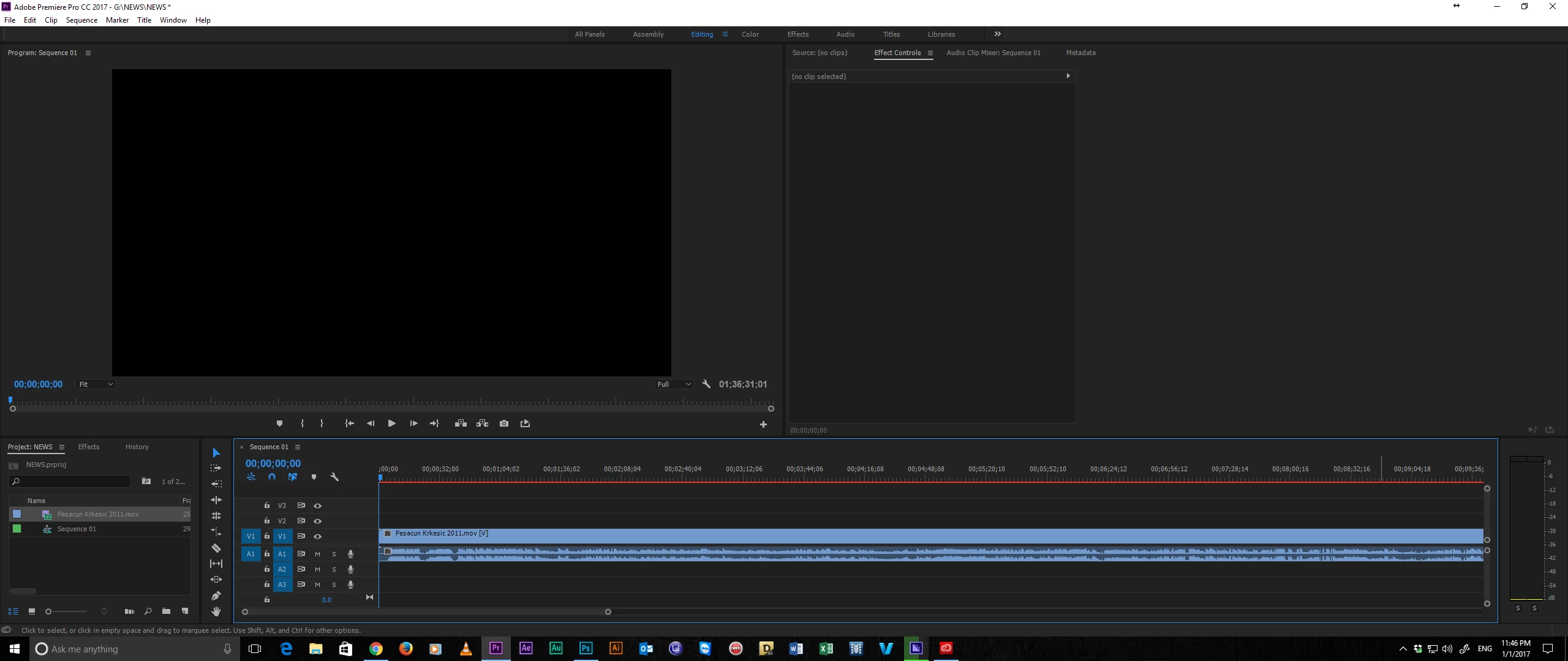

Premiere Pro CC 2017 - Footage is Red in Program window (Possibly Corrupt??)
I am using Premiere Pro CC 2017 on my laptop, and I was editing my footage as I usually would, and in the Program window, the footage was a red color (see picture below). Most of my other clips were fine, they were not different at all. After re-importing the footage, it was back to normal, but then it went back to being red. I was wondering if anyone else had this problem and if I did anything wrong to make this happen. My video tracks were turned on, the original files were not corrupt, I only changed the speed and tried time remapping on the clips, and I didn't see anything that I did to make this happen.
Are there any solutions to this problem?
Thanks very much,
Matthew F
ChristopherSBCorrect answer
Mar 29, 2017 5:09 PM UTC
I believe I was having the exact same issue (Premiere CC, Win 10, Core i54690K, 16G RAM, no video card). Unchecking Accelerated h.264 decoding appears to have worked.
Don't know if this is additional information, but I was NOT having trouble on a very simple timeline. Trouble only started happening when I was working on something with 7 or 8 video layers with dozens of source clips. Source clips are all mp4.
Thanks!
-Chris

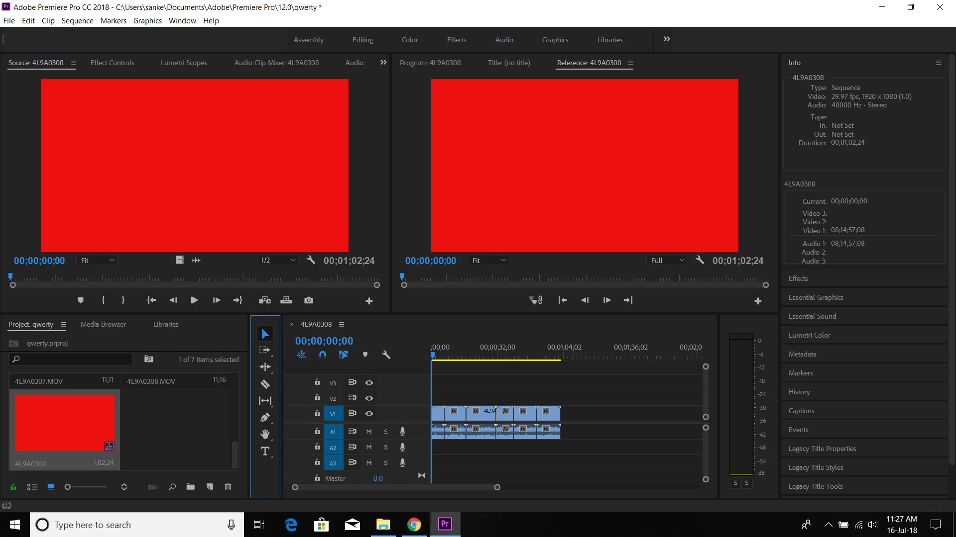

Jul 16, 2018 5:59 AM UTC
plz help me
i import a video footage and its been turn it to audio file and its red
Jul 16, 2018 8:12 AM UTC
Quick fix - In Preferences > Media > Uncheck "Enable Accelerated Intel h.264 decoding"
•This will disable hardware decoding, but you will use more CPU when going through your timeline
Full Fix - Use DDU to uninstall your display drivers, this must be done with windows booted in safe mode. Restart system and let windows reinstall the display drivers. you can force this by checking for updates via windows. After your videos drivers are reinstalled, reboot the system and hardware decoding should be working again.
•This will give you the best performance when editing
•If you have and AMD or Nvidia graphics card, uninstall those drivers before your intel video driver and do not reboot inbetween uninstalling drivers.
Jul 16, 2018 3:57 PM UTC
Thank you so much the Quick fix worked

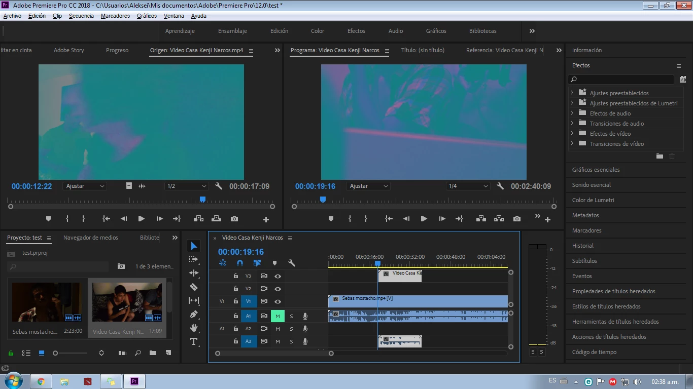

Jul 13, 2018 7:39 AM UTC
happening same with me! i dont know what to do! mp4 format, adobe premiere cc 2018, omg so many problems this new versions,
