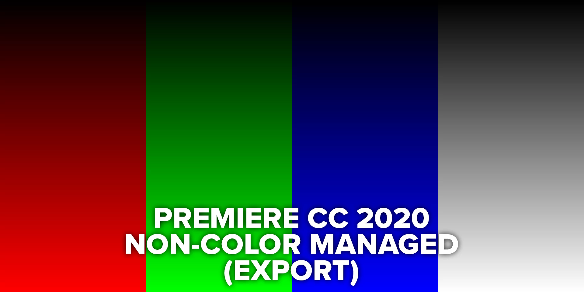

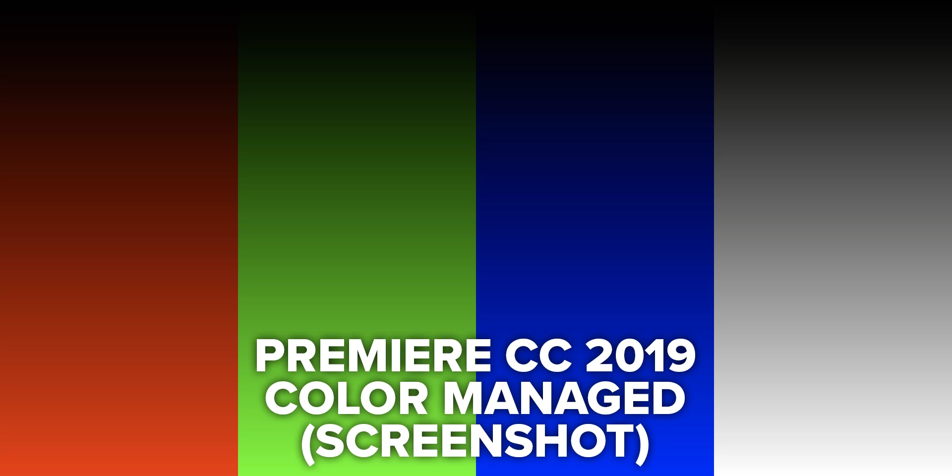

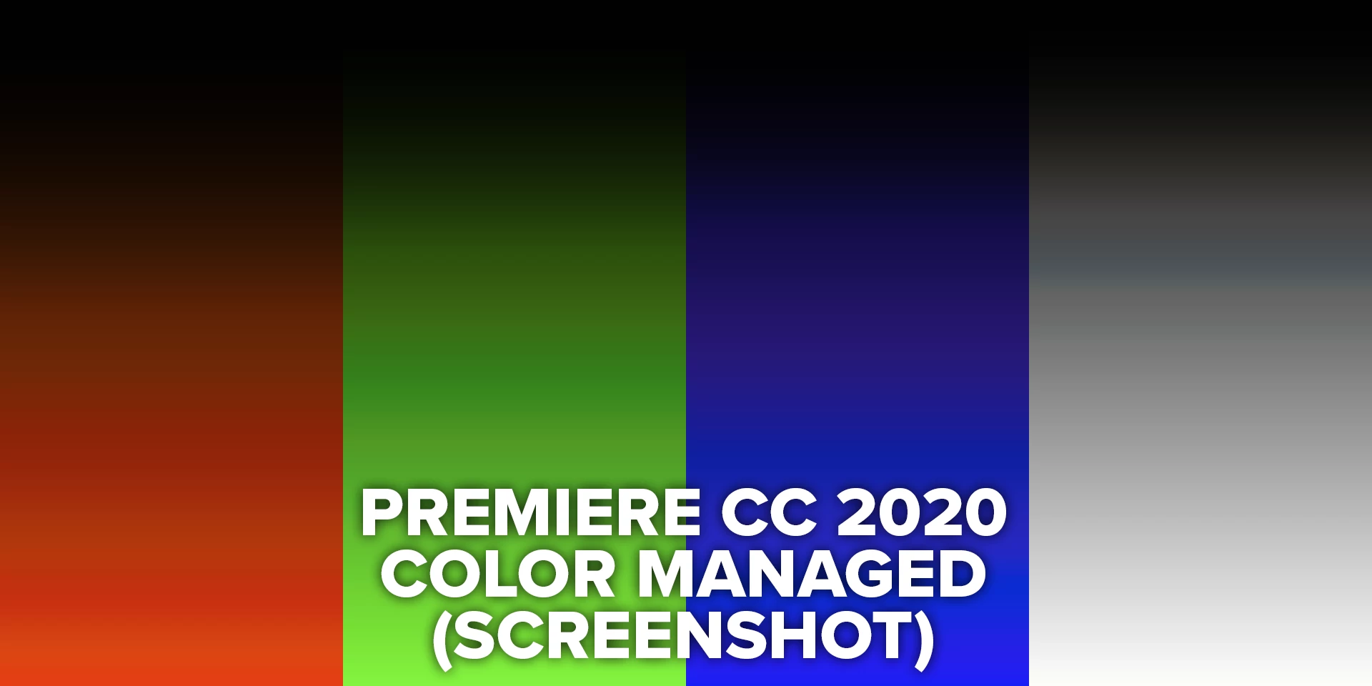

Simply put - the Display Color Management seems buggy. If enabled, it causes severe banding in the image. I have attached sample images as proof, showing the following
- unmanaged images from both 2019 and 2020, which both look identical
- managed image from 2019, which shows how it 'should' look (reduced saturation and a change in gamma)
- managed image from 2020, which replicates the issue (for example, the harsh blue tint in the greyscale midtone, and the general corruption of colour in the other 3 channels. Obviously the effect is more noticeable with a captured image, but the ramps represent it more informatively).
This means that the DCM option is more or less unusable in 2020, at this stage.

I got a response from Jarle Leirpoll ... ( premierepro.net, author of several books on Premiere) and it may be of use.
"I've seen this happen when the monitor is "calibrated" using Spyder, X-rite etc.
They call it calibration, but it's really just profiling. And if the correction in the profile is rather large, it will cause banding. Add the extra internal gamma correction that happens with DCM, and it may be more visible."
Essentially, if the profiling step of the X-rite or Spyder process has to make some major changes in remapping pixels to match the needed chroma/gamma curves, then when Premiere applies whatever it does to the image going to the Program monitor results in skipped values.
From what you've listed for your process, I can't see that DCM would be of use to you anyway. Feel free to leave it off. It works best with uncalibrated monitors actually.

I also struggled to find the right word to describe it - 'banding' is close, but if you look at the top half of the corrupted gradients above, you'll see the colours themselves are significantly different than in the 'correct' versions of the gradients.
