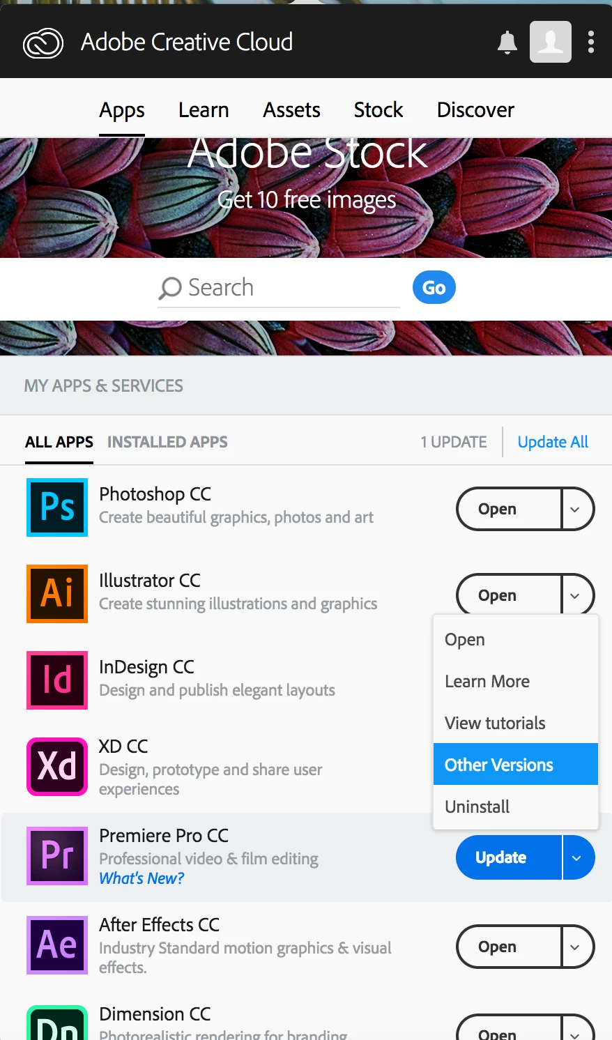

    Roll back a version (in my case, version 12.0.1) – open up the Adobe CC app, select the "down" arrow next to Premiere's pill-shaped "update/open" button (not the main part of the button), and choose "other versions" from the popup. Hit the 'Install' link next to 12.0.1 - should be the first link on the top.

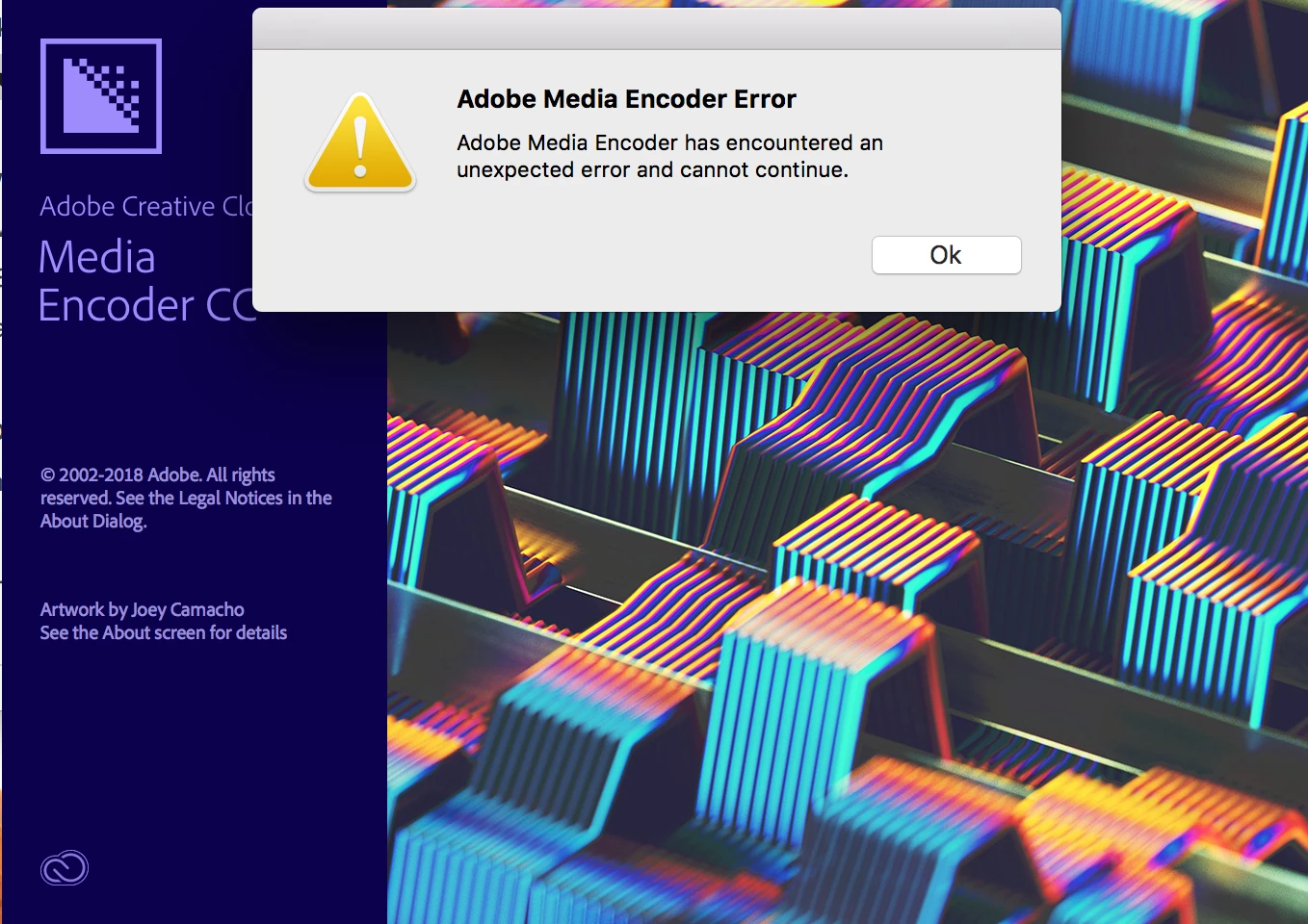

    Had the same issue with Media Encoder, and the solution was the same - roll back to version 12.0.1
