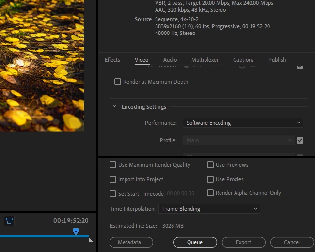

So "Render at maximum depth" seemed to be the culprit for me....  I had seen that the there is an flicker option if you right click the selected  images on the timeline and choose "field options" and "Flicker Removal"... But in an extra step in the same swing I shut off render at max depth and render and use max render quality. It dissapeared. So now I am adding them back amongst other tests.... It takes a while but yeah. That should do it.
