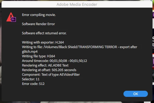

When I double click on a clip in the timeline, I get the spinning rainbow wheel of death EVERY TIME and then I have no choice but to force quit and I will include here a screenshot of the message I get every time after I am forced to force quit:
I tried restarting my computer. I tried uninstalling and re-installing Premiere. And NOTHING WORKS. The same problem persists.

All of my video files and project files are organized into folders on my external hard drive (3 TB western digital passport, with over 600Gb of free space left on it). My macbook's hard drive has over 250Gb of free space.
I tried exporting the full hour and 22 minute in HD as I normally would, and after it reached about 3% it had an error message:
The export wound up only being the first minute and 50 seconds...
So then I just re-exported the full project at the lowest quality possible (480p) and this time the whole thing exported.
To answer your question, I just opened the oldest auto save file I could find for this project (august 28th), and it worked just fine. The latest and more important version of this project is still giving me the same problem.
I have noticed that occasionally I can go to the end of the latest version, and eventually I can get it to work, but as soon as I click back to the beginning of the timeline, the problem occurs and I am forced to force quit.

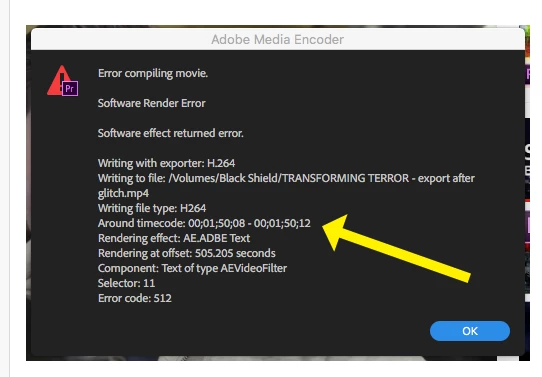

There is something wrong with the video between 1:50:08 and 1:50:12 on your timeline:
Go to that portion of the timeline and look at the source file. If it is OK, then re-edit it back into the timeline, re-render the effect (if needed) and then test export.
