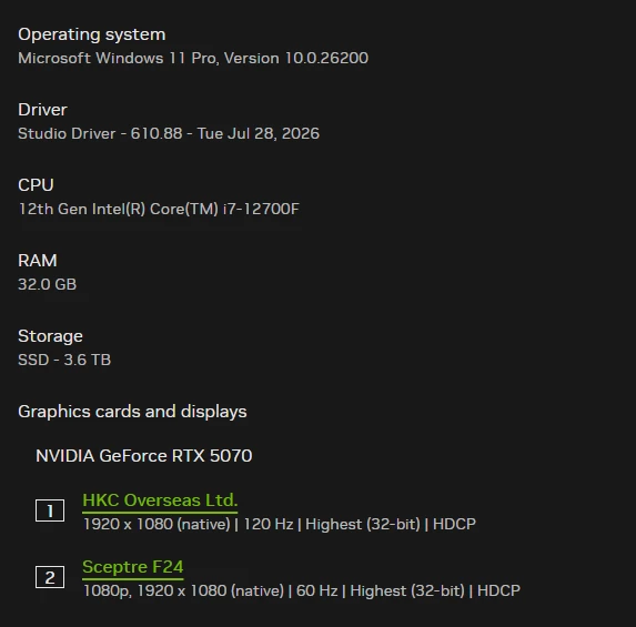

My system stats look like this when it crashes:

This is my set up if that helps:
