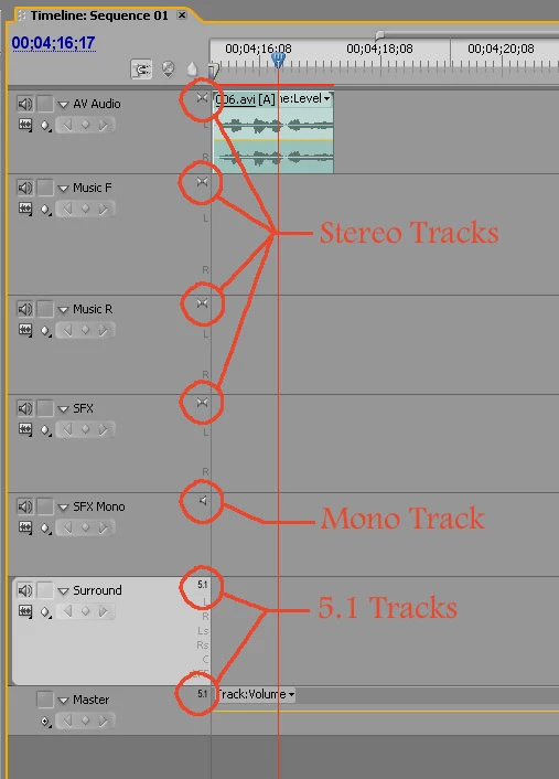

    For the behavior of the Audio Clips, PrPro insists that the channel-count of the Clip match the channel-count of the Audio Track. If you look at the Audio Track's Header, you will see a little "speaker" icon in the upper-right of the Header. One speaker = 1-channel, two speakers = 2-channel and 5.1 = 6-channel.
    When one creates a Sequence, they can adjust the default number of Audio Tracks, and the channel-count of these. For the default, if one has set this to two 1-channel (mono) Tracks, two 2-channel (stereo) and one 6-channel (5.1) Tracks, they will be created in that order, with Audio Tracks 1 & 2 being 1-channel w/ only one speaker, Audio Tracks 3 and 4 2-channel w/ two speakers and Audio Track 5 with "5.1" for 6-channel. A 1-channel Clip will ONLY go onto Audio Track 1 or 2, in this example.
    Now, PrPro is quite smart in this regard, in that if you have a Sequence with zero 1-channel Tracks, it will create one for you, if you drag that Clip to the lower part of the Master Track, but that new Audio Track will now appear at the bottom of the Track stack.
    Here's a look at the speaker icons:
    Good luck, and hope that this helps,

    Also note that you can change the default Track setup for each new Sequence. If, for instance, you usually have several 1-channel Tracks, say for SFX, set your default with those, plus any normal 2-channel Tracks, and any 6-channel (5.1) Tracks, if you work with original 5.1 Clips. If you do not use all of these, you can Delete Unused Tracks (Audio, and/or Video) to clean things up a bit.
    One can also Rename the Audio Tracks, as I have done in my example above. One then does not have Audio 1 through Audio X.
    To swap Tracks around, one needs to do a little "dance." One can create new Audio Tracks, where they want, and with the channel-count required, as one can Delete Tracks, but they cannot click-drag Audio Tracks around, as one can with many DAW programs. This has been a fairly common Feature Request, especially from folk, who work a lot with a DAW.
    Good luck,
    Hunt
