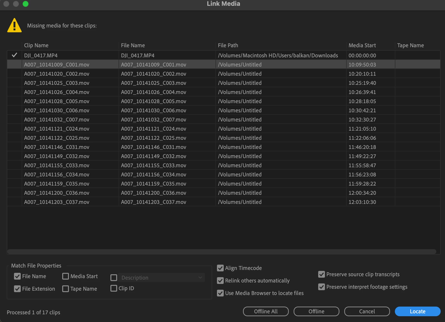

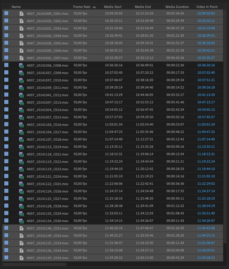

Hello, I need help on a serious issue that keeps happening during the last few days. The issue is that in the middle of my work, some of the files in my project go offline. Then when I try to relink them, it says that there's a generic error. Then I try to find those clips in Finder and they're gone! They don't exist. They're not in the trash can. When I tried downloading the missing files again and copying to the same directory there was another error (attached pic). I am really panicking because I'm an editor and it's a serious issue. The files were on the external HDD, I thought that the HDD is faulty and copied everything to another one but the same thing happened. I'm using Mac Studio M2 32GB 1TB and Premiere PRO 2024 (happened on a previous version too). Did anybody have the same issue??

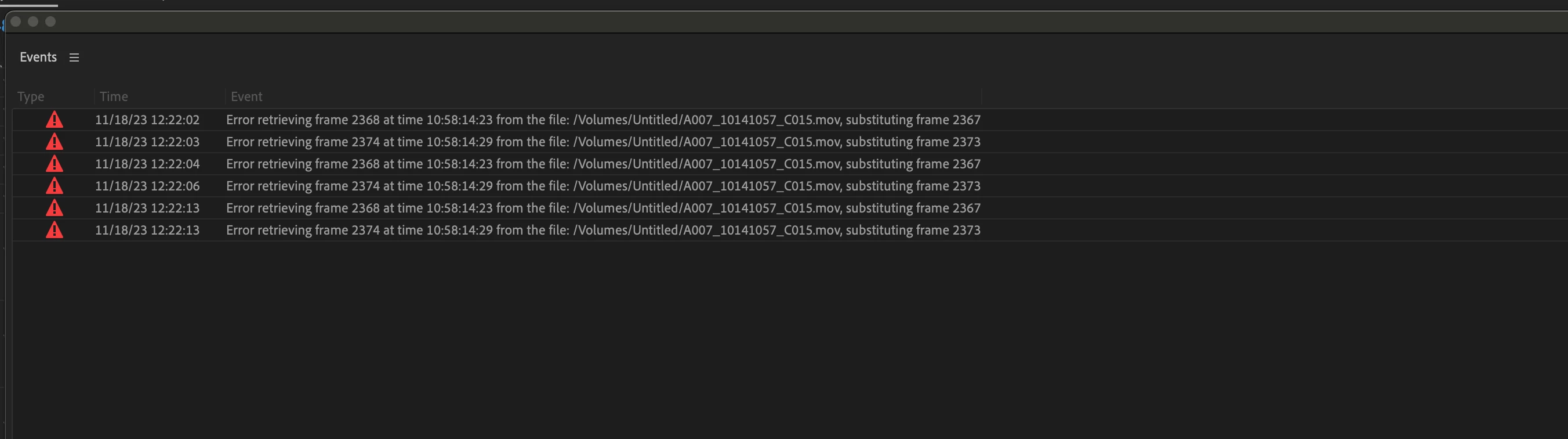

These are the error messages that first appears:
Then the files went offline.
And when you check your SSD, the files dissapeared.
First Aid is showing no errors with SSD:

I've just got the same problem with:
SanDisk 1TB
Format: ExFAT
Premiere Pro 2024
All files that have been used into the sequence just got dissapeard from SSD.
Other imported files are still present.
This is a second time that it's happening to me!
Any permanent solution?
