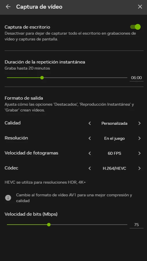

It seems that the problem might be related to NVIDIA Experience. I have researched the available options, and they are quite basic, as shown in the screenshot; there is little that can be done. If any user encounters this issue and uses this program for recording, noticing that when importing it into Premiere, the audio becomes desynchronized, or when exporting the video, it gets cut in half, one option would be to use a different editor. In my case, I don't want to advertise Filmora, but this program can perfectly handle this type of file.
If the video file is short, there is no problem, but the inconvenience arises when working with large files, especially those exceeding one hour in duration. It is worth noting that if you transcode the file, it works, but the processing time is extremely long. So far, the fastest solution is to use Filmora instead of Adobe Premiere, as I have edited five projects with Filmora and have not encountered as many issues as with Premiere. Thank you all for your help.
