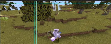

@aliceh85535058 i tried your tips but didnt worked
actually whenever i import my recordings into premire pro the glitches randomly appears
it happened with my recording of minecraft done with obs studio with the following settings
i tried export this but the same glitch was there however in my original clip there is not such things
i even opened a new project and from there exported the clip and replaced it but still
i need help guys i am in a deadline please
July 4, 2023
