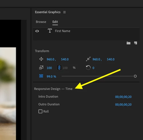

    As you have discovered, keyframes do not change when the clip that hosts them has a duration change.
    The easiest way to do what you want is to build your graphic with Essential Graphics and use the "Responsive Design -Time" feature of Essential Graphics:
    which will let you set Intro and Outro durations that will remain constant even when the overall duration of the clip changes.
