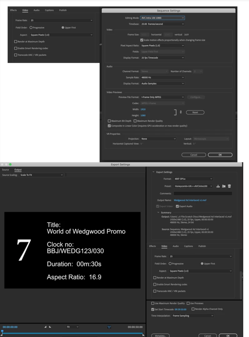

I'm currently preparing some video for ITV HD. I'm running into some issues. Any help greatly appreciated.
This Ad must go through Clearcast and to check the footage they use some standard templates on Vidchecker. It is failing my footage however, my footage passed the DPP template on Vidchecker when i ran the task.
Here are the ITV HD specs
http://dpp-assets.s3.amazonaws.com/wp-content/uploads/specs/itv/HDCommercialsSponsorshipMaterialStandardITV.pdf
I used the AS-11 preset to produce the mxf file and ran it through the DPP template. It passed ok. I sent it to Clearcast and they failed it immediately. Upon further reading i discovered this in their FAQ's
Adobe Media Encoder / Premiere / Episode
We spent a number of hours testing Adobe Media Encoder (AME). We tested Adobe Media Encoder CC 2015.0 release, (build 9.0.0.222). Unfortunately we were unable to convert a progressive source to Interlaced Top-Field first. Some attempts produced a file that reported to be of the correct specification but upon analysis we discovered that the video was still progressive.
We spoke with Adobe Support who confirmed that AME is not able to convert a progressive source to Interlaced Top-Field first. A number of agencies have reported issues with this piece of software. We believe the same is true for Adobe Premiere and also Episode.
We do not recommend the use of this software to produce files for CopyCentral
So with this in mind would i be correct in thinking that because ITV requires Clearcast to clear the video that Adobe Premiere is simply not accepted anymore?
If anyone has an ITV HD preset i could try i would be most grateful. Any advice appreciated.

    Indeed it was, however this information is still current on their website. This is why i queried it. They have yet to reply.Please see the mediainfo below
    R Neil Haugen
    August 8, 2018
    That is showing upper first ... wonder what the deal is? Why does it show upper first if ITV says it isn't? Huh
