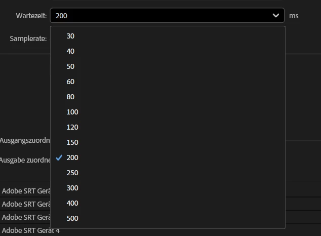

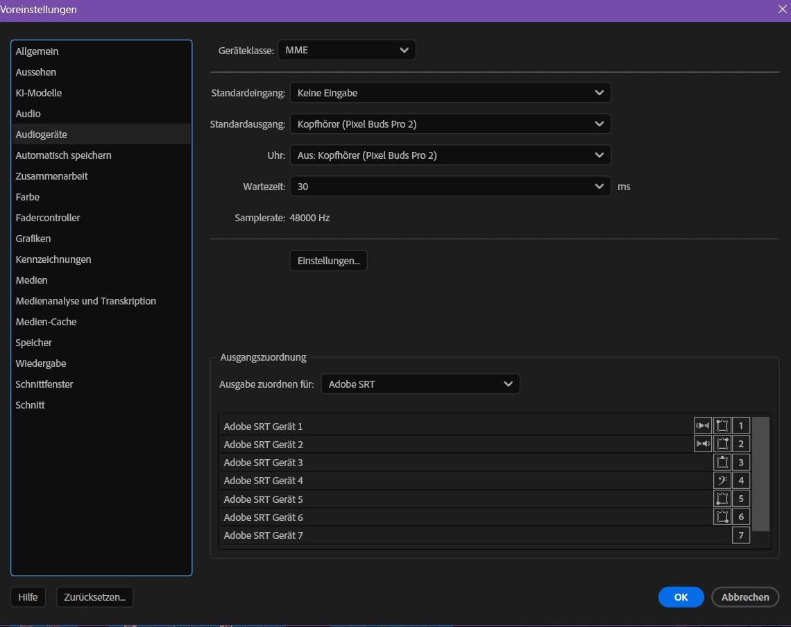

June 4, 2025
Everything looks fine.  You should not set the “Wartezelt” setting so low.  Set it to 200 or higher and see if that helps.
Also, Bluetooth is notoriously poor for high quality connections.  When using the microphone with a bluetooth headphone the sample rate will switch to a very low setting, sometimes automatically.  This is just inherent to how bluetooth work.
Premiere needs to have a full duplex device for optimal usage.  You might need to experiment with using the different virtual blue tooth devices that are presented to the operating system, and avoid using the headsets built in microphone.
Essentially, you cannot activate the bluetooth microphone while using Premiere or it will cause issues with playback.

Hony_Mannheim
June 30, 2025
Thank you, mstegner. Setting the 'Wartezeit' higher worked.
THANKS A LOT!

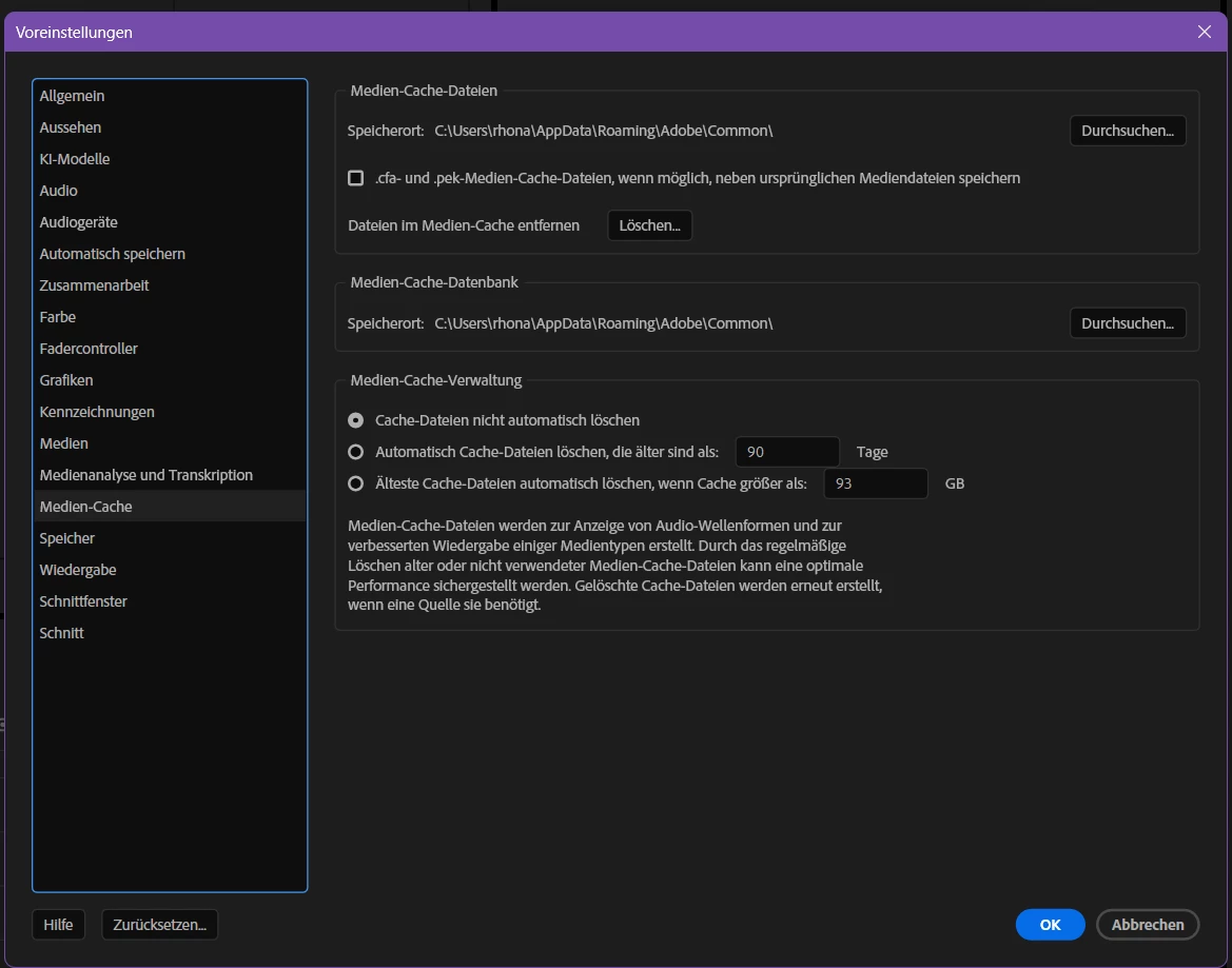

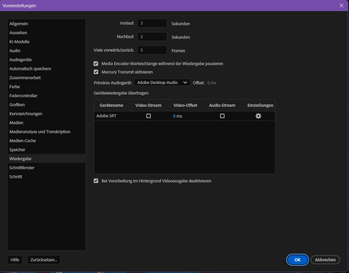

Hony_Mannheim
June 3, 2025
@mstegner
Preferences>Audio Hardware
Preferences>Media Cache
Preferences>Playback
Hony, Grafikkünstler aus der Pfalz, der gerade in der Quadratestadt Mannheim sein Unwesen treibt.

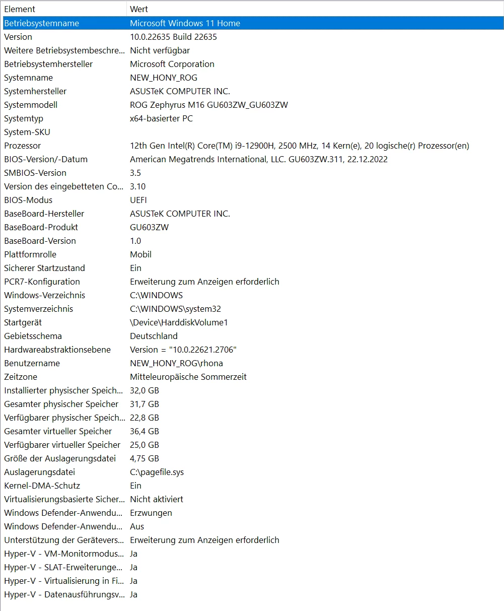

Hony_Mannheim

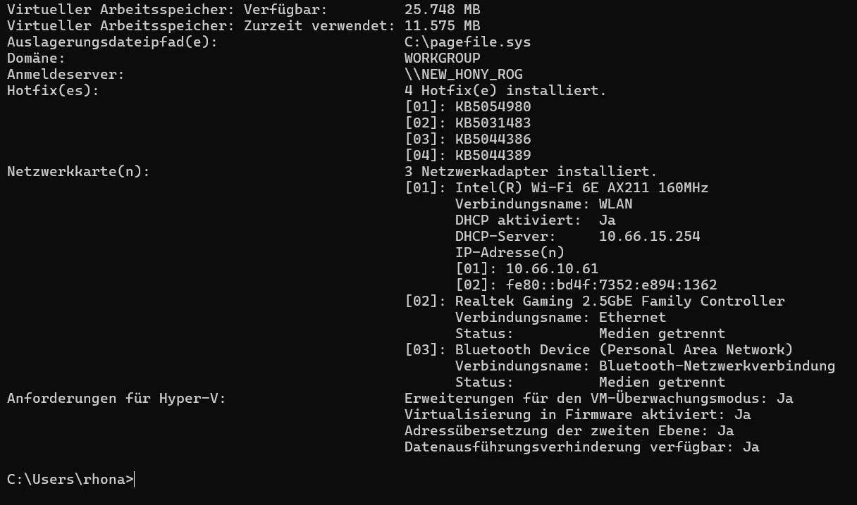

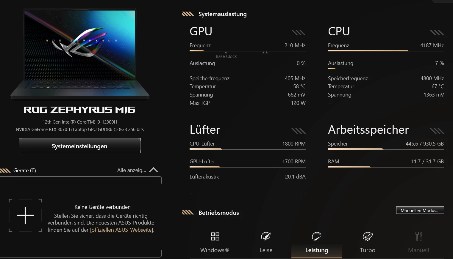

June 3, 2025
@mstegner
Ist es dsa was du brauchst?
Gerätename NEW_HONY_ROG
Prozessor 12th Gen Intel(R) Core(TM) i9-12900H 2.50 GHz
Installierter RAM 32,0 GB (31,7 GB verwendbar)
Geräte-ID 41AF68DF-4677-4EA7-9278-DB14D46CB7D1
Produkt-ID 00342-20935-94789-AAOEM
Systemtyp 64-Bit-Betriebssystem, x64-basierter Prozessor
Stift- und Toucheingabe Für diese Anzeige ist keine Stift- oder Toucheingabe verfügbar.
Edition Windows 11 Home
Version 23H2
Installiert am ‎12.‎10.‎2024
Betriebssystembuild 22635.4300
Leistung Windows Feature Experience Pack 1000.22700.1045.0

Hony_Mannheim
June 2, 2025
@Mariam Hovhannesyan
sind das die Informationen die dir weiterhelfen?
Wie geschrieben, wenn ich die Kopfhörer entkoppele, läuft Premiere Pro einwandfrei.

Hony_Mannheim
June 2, 2025
Hallo Mariam,

June 2, 2025
Can you tell us your computer parameters? Maybe is it the problem with the computer settings?
