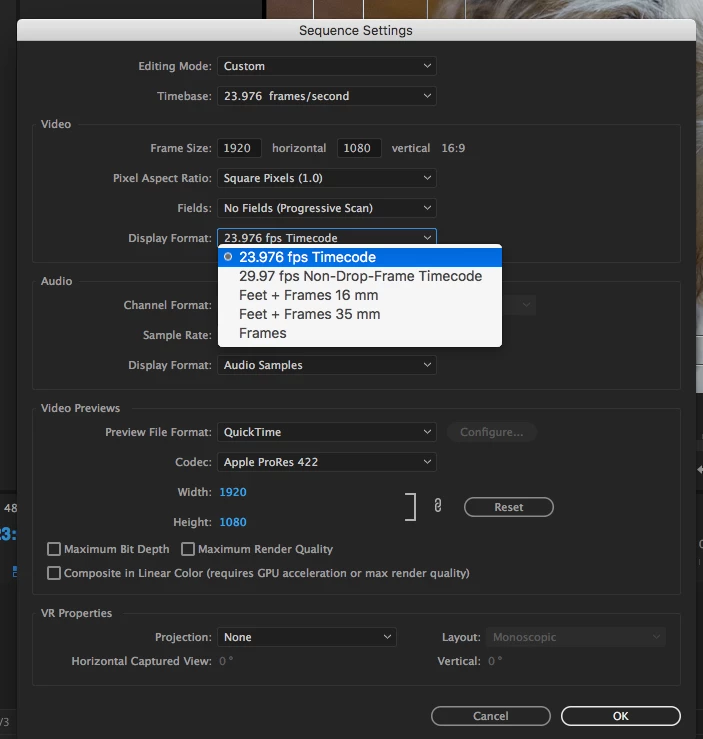

As I said, there is no drop frame option for timecode at the 23.976 frame rate - on any system. You only have one choice for timecode at 23.976:
So you have to have a way of determining what the realtime length is going to be - there are on-line calculators available to do the math - you can google search for them.

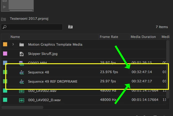

If I have to edit program length material at 23.976, I create a second sequence at 29.97 Drop Frame and nest the first sequence (the 23.98) into the 2nd as needed during the edit to check program length.
