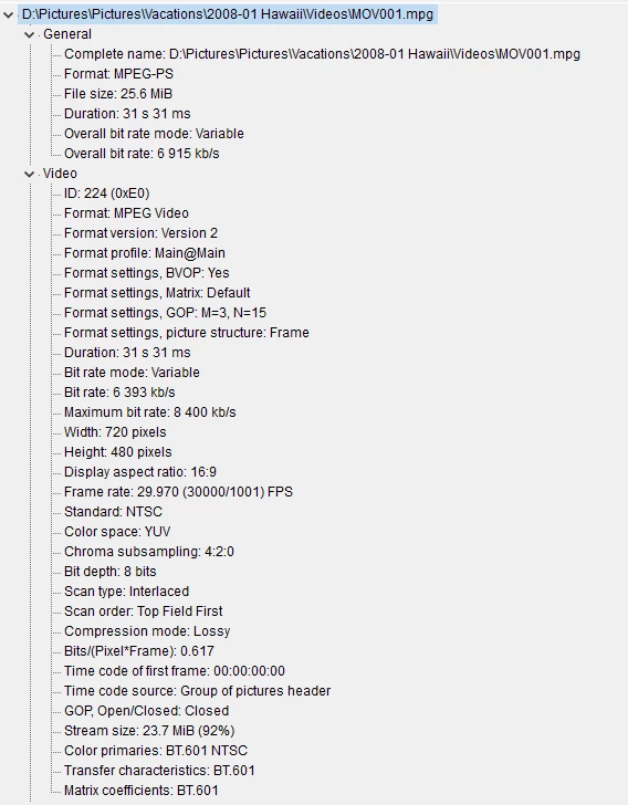

ps. mediainfo export :
General
Complete name                            : D:\Pictures\Pictures\Vacations\2008-01 Hawaii\Videos\MOV001.mpg
Format                                   : MPEG-PS
File size                                : 25.6 MiB
Duration                                 : 31 s 31 ms
Overall bit rate mode                    : Variable
Overall bit rate                         : 6 915 kb/s
Video
Format                                   : MPEG Video
Format version                           : Version 2
Format profile                           : Main@Main
Format settings, BVOP                    : Yes
Format settings, Matrix                  : Default
Format settings, GOP                     : M=3, N=15
Format settings, picture structure       : Frame
Bit rate mode                            : Variable
Bit rate                                 : 6 393 kb/s
Maximum bit rate                         : 8 400 kb/s
Width                                    : 720 pixels
Height                                   : 480 pixels
Display aspect ratio                     : 16:9
Frame rate                               : 29.970 (30000/1001) FPS
Standard                                 : NTSC
Color space                              : YUV
Chroma subsampling                       : 4:2:0
Bit depth                                : 8 bits
Scan type                                : Interlaced
Scan order                               : Top Field First
Compression mode                         : Lossy
Bits/(Pixel*Frame)                       : 0.617
Time code of first frame                 : 00:00:00:00
Time code source                         : Group of pictures header
GOP, Open/Closed                         : Closed
Stream size                              : 23.7 MiB (92%)
Color primaries                          : BT.601 NTSC
Transfer characteristics                 : BT.601
Matrix coefficients                      : BT.601
Audio
ID                                       : 189 (0xBD)-128 (0x80)
Format                                   : AC-3
Format/Info                              : Audio Coding 3
Mode extension                           : CM (complete main)
Format settings, Endianness              : Big
Muxing mode                              : DVD-Video
Duration                                 : 30 s 784 ms
Bit rate mode                            : Constant
Bit rate                                 : 384 kb/s
Channel(s)                               : 2 channels
Channel positions                        : Front: L R
Sampling rate                            : 48.0 kHz
Frame rate                               : 31.250 FPS (1536 spf)
Bit depth                                : 16 bits
Stream size                              : 1.41 MiB (6%)

November 7, 2016
Here's the screenshot. (SOrry I had not noticed the request...)

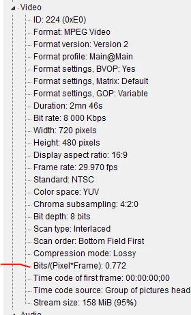

i found this is different in a standard NTSC video exported from Edius
Muhannad,
