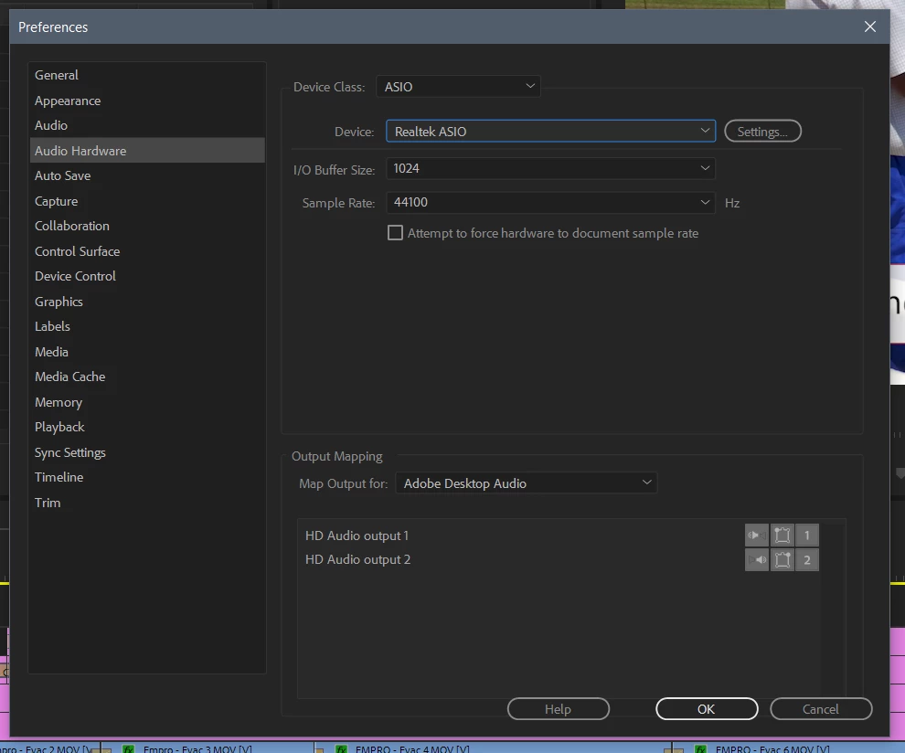

Hi Ann, thanks for the response.
I don't have that option, here is a screenshot:
Ann Bens
May 13, 2018
Set Device class to MME.
