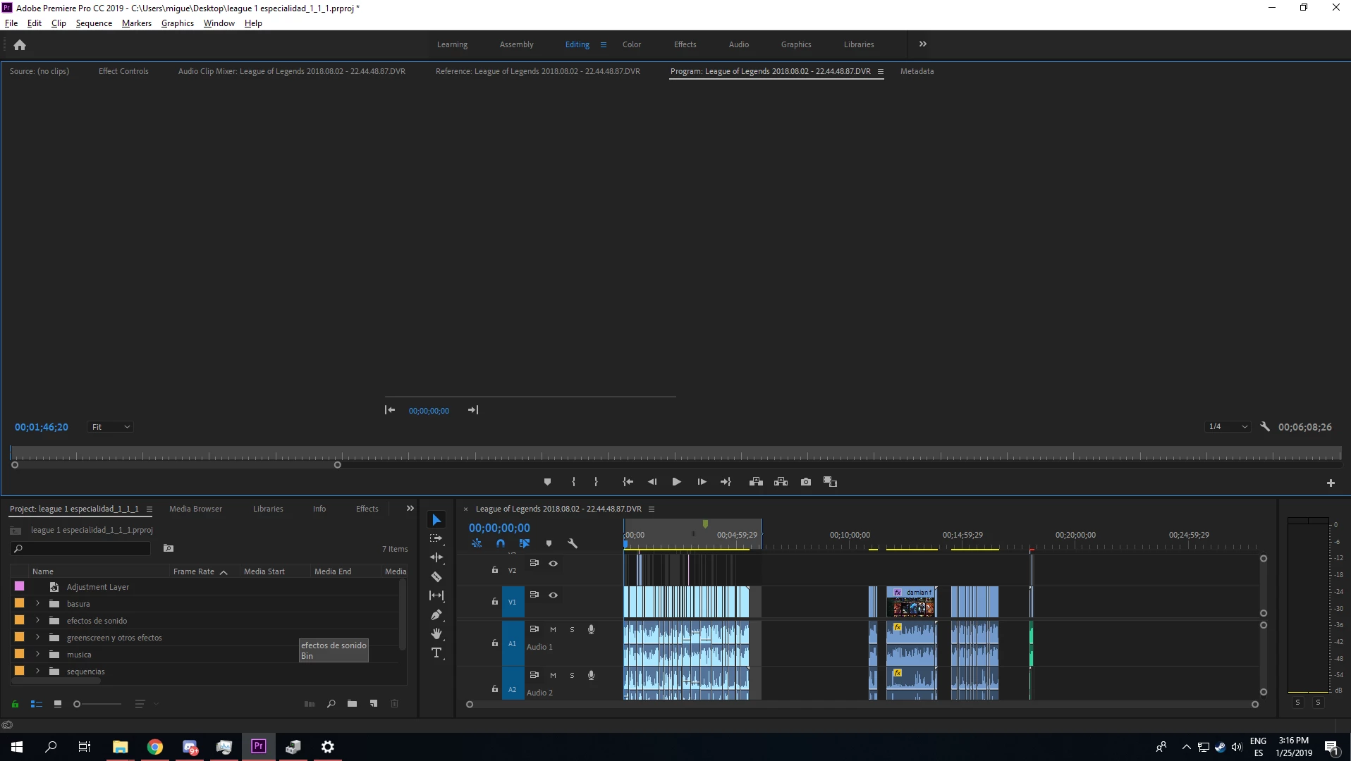

I'm having a problem with my adobe premiere pro where there is not picture in my promgram monitor or source monitor. Also timeline blue marker don't move. Sometimes the audio files would play.
I already :
-Restarted preference
-Chaged Alpha, composite video, etc...
-Cleaned media cache
-Changed renderer
-Made a rollback in nvidia drivers
-Installed other version of Premiere Pro
-have the lastest drivers for everything
CPU: AMD Ryzen 7 1700
GPU: Evega 1070
Windows 10 pro
M.2 sdd for the files
Notice that this problem showed up first in the latest version. After installing the version 11.1.4 (2017) worked perfectly for a day and the same issue showed up.
Also after closing the program would run in the background I had to use manager task to end it before open it before.
I would format and reinstall everything as last resource.
Thank you for your time.
