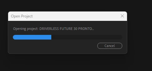

Premiere Pro Project stuck on "Open Project"
I left a project exporting last night, and came in this morning and the project had crashed.  When I try to reopen any of the multiple projects in this folder - they all "get stuck" on the "Open Project" screen.  If I make a new project in this folder, it opens, works, and has no issues.   The error seems to be associated with just this project.  When I hit cancel or close the loading window, the program goes white screen and crashes.  I get no error codes.
This is a multi project project.  I have been working on it for over a year without issues.  I had opened multiple projects to move items around before I left it to export.  But as best I could tell everything was working when I left it ot export.
Here's what I have tried to fix it, none of these have worked:
-Cleared the media cache.
-opening it project manager.
-importing the project into a newly created project.
-importing it in as a sequence
-tried using project manager to import
-went through old versions of the project in auto save folder trying to open them to get a new starting point.
-tried importing old versions of the project in auto save folder trying to open them to get a new starting point.
-tried opening the project on another computer from the same server.
-Copied the project file to my desktop and tried to open it from there.
What can I do to get the projects to open.  I suspect that once one opens, the others in the folder will follow suit.

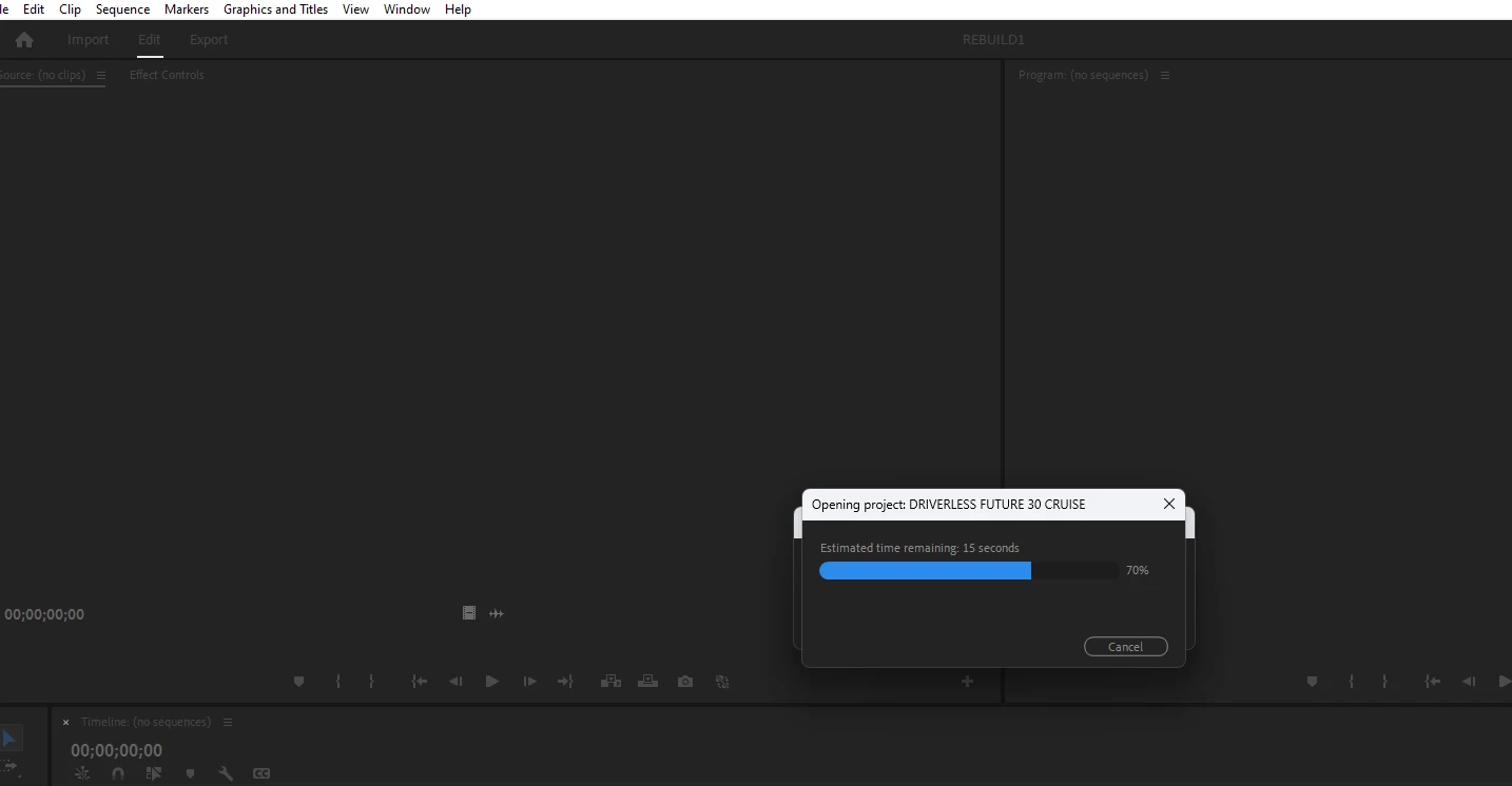

May 8, 2025
Here is what it looks lie when I try to import - it zips along and then gets stuck at 70%
