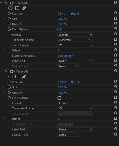

When I add time code for adjustment layer time code not starting with zero (0) it's starting like 01:00:00:0 and also same problem for frames (normal and 16mm/35mm) how can solve this?
Finally, i need that all to be started with zero (0)  (timcode / frames/frames+feet )
hope you guys help
thanks in advance
****am adding two-time codes for one adjustment layer*****
I have given images for reference
Above image ( third one) is time code with frames+feet ( 35mm)

Your Problem 2 i.e needing the time-code to start at zero, can be solved by generating a transparent caption instead of using the the adjustment layer.  You need to create this with the Legacy Title Tool.  File> New> Legacy Title Tool.  Call it Blank Frame or something similar and close the title tool immediately.  This will create a transparent frame that you place on a video track at the the top of the timeline, for the whole duration of the material.  Place the time-code effect on this caption and you will be able to set the code to zero.
I hope this helps.
August 20, 2017
You can also use a Transparent Video for this. New Item > Transparent Video.

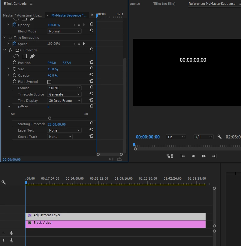

I see the same behavior... the Adjustment layer starts at 1;00;00;00 ... so far I see the possible workarounds...
  • I have used timecode before but I never would have thought to apply it to an adjustment layer... do you have to do that? Can you apply it directly to your clip... or if you have more than one clip, can you nest the clips and apply it to the higher-level nest?
  • If your sequence is less than hour long, you can apply a mask to timecode to only allow the minutes/seconds/frames to be visible. See screenshot at end of post.
  • I notice timecode wraps at 24 hours... so if you set the start to 23;00;00;00 (23 hours), it starts at 0;00;00;00 ... Note, I cannot guarantee this hack will work across releases. See screenshot at end of post.
I'm not sure if this is by design or not... I can't see a good reason for force adjustment layer timecodes at 1 hour... can you file a bug at the following link? Feature Request/Bug Report Form  The team can then review it and process it accordingly.

screenshot using a mask:
using 23;00;00;00 to force wrap to 0...
