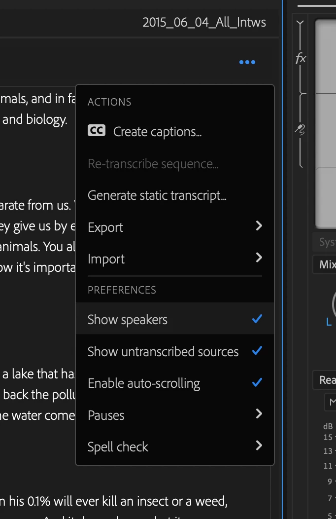

I've been using the auto-transcription tool a lot lately, and the update makes the interface look better but now the separate speakers are not being identified.I have "Show Speakers" selected and I also went through the extra step of clicking "Generate Static Transcript" under which you can select "Separate Speakers." The only speaker being shown in the generated transcript is "Unknown." If I change the name of this Speaker, it changes every line to that speaker.

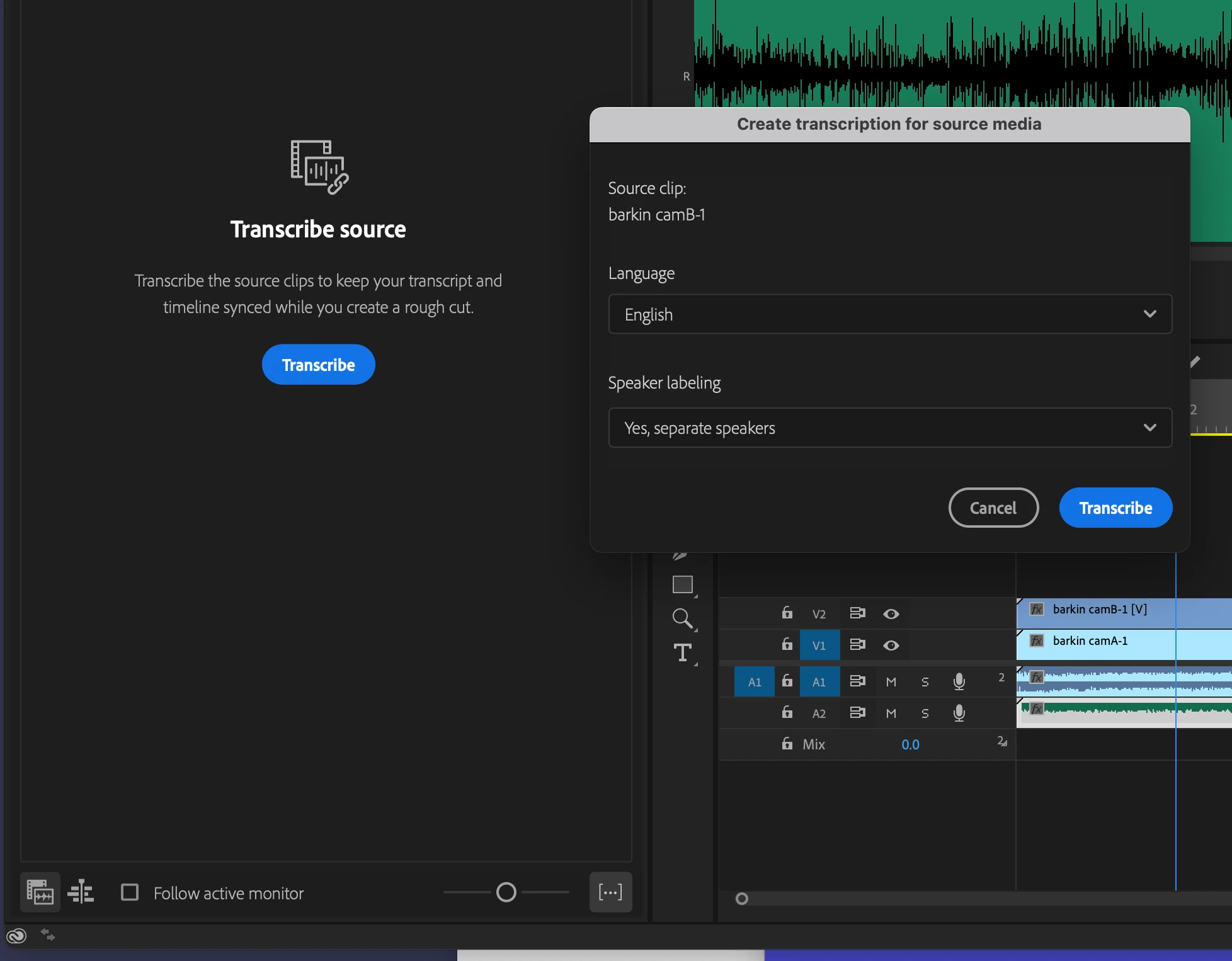

Sometimes, you have used the 3 dots menu to confirm that "Show speakers" is checked. This setting, however, only tells PR to show the speaker designations in the transcript window. It does NOT mean that speakers will be identified during transcription.
And then when you used the transcribe button in the "untranscribed sources" prompt, it did not have speakers set.
When you get the "Create source media transcription" dialogue, you get the actual "Separate speakers" option. And then it works.
I have not discovered exactly when it does not show the dialogue and whether it sometimes ignores the speaker separation if you set it in preferences.
In any event, check Edit -> Preferences -> Transcription and be sure you have speaker separation set there. If it shows "Select an option," it is not set. You can set it there by turning on "Automatically transcribe clips," setting speakers to "Yes, separate speakers," and then turning off "Automatically transcribe clips."

Dear Francis-Crossman, the updated transcription interface has new bells and whistles that make it more confusing, and I'm getting the same problem as the others. All my speakers are identified as "unknown" which didn't happen in the previous version on the same exact interviews.
In addition, when I try to re-transcribe, that menu item is gray-out and therefore unavailable.
When I select Source Monitor transcript, it successfully separates out the speakers, but I'm not sure how to deal with that when an interview has more than one clip. I believe there are several bugs in this new interface that need to be fixed.

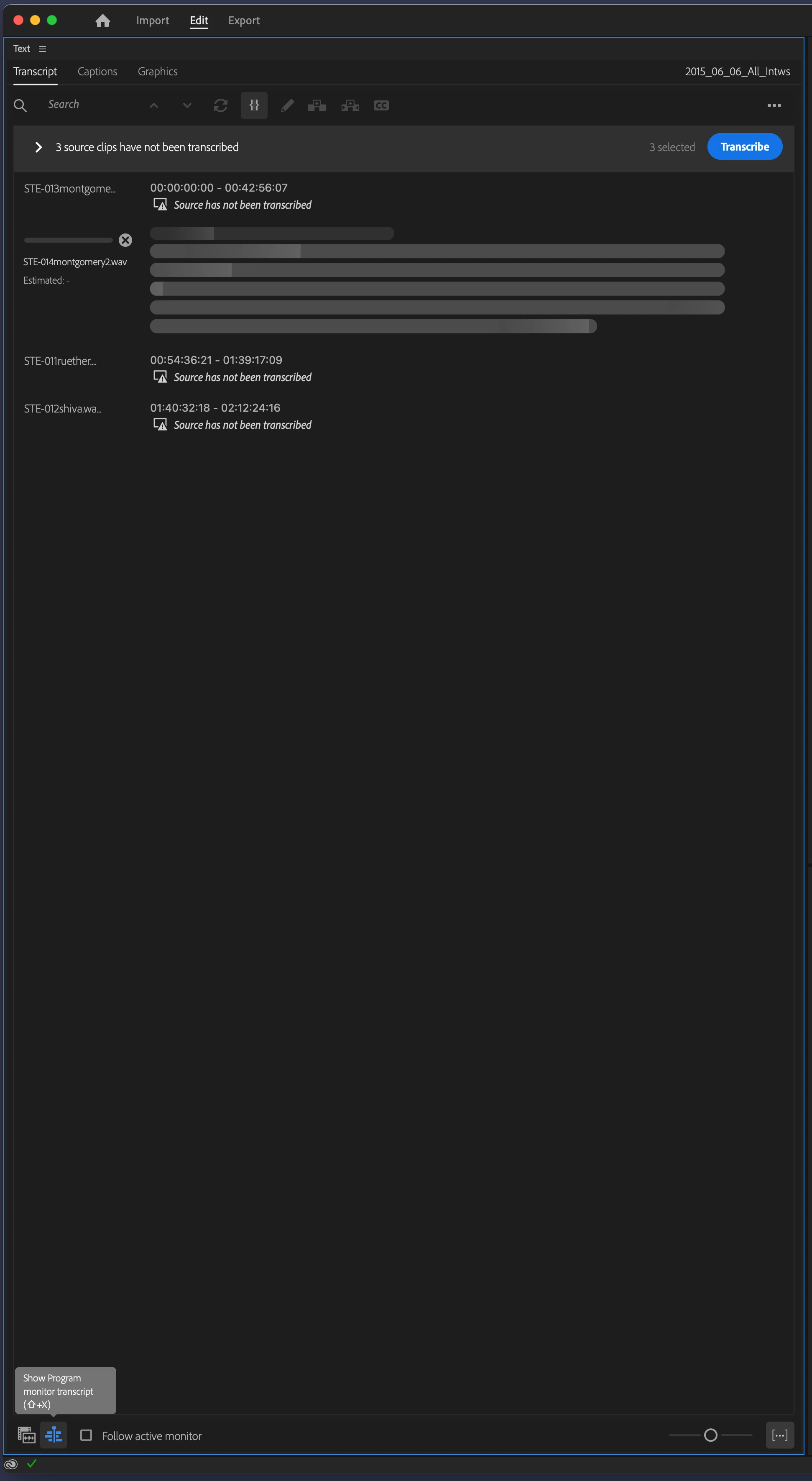

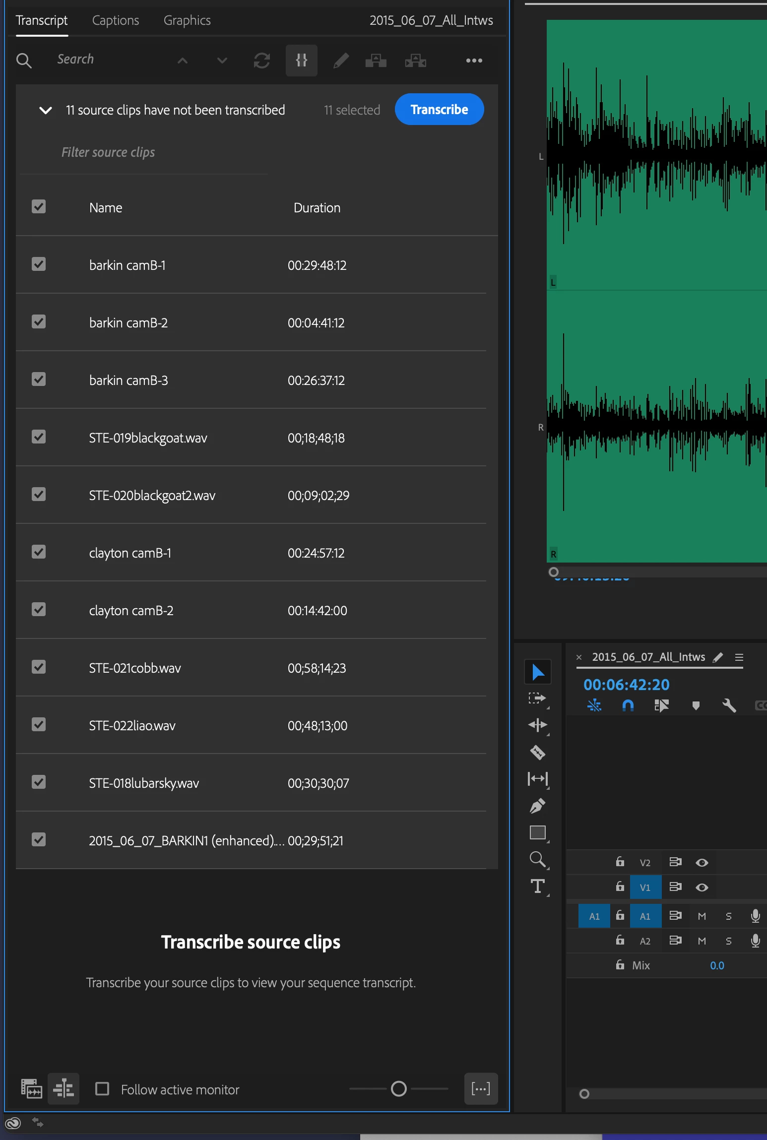

Sepreating Speakers during a transcription seems to work when I launch the transcription from this window:
However, Seperating Speakers Seems to fail and give me the "Unknown" problem when I launch the transcription from this window:

Works:
Doesn't work:

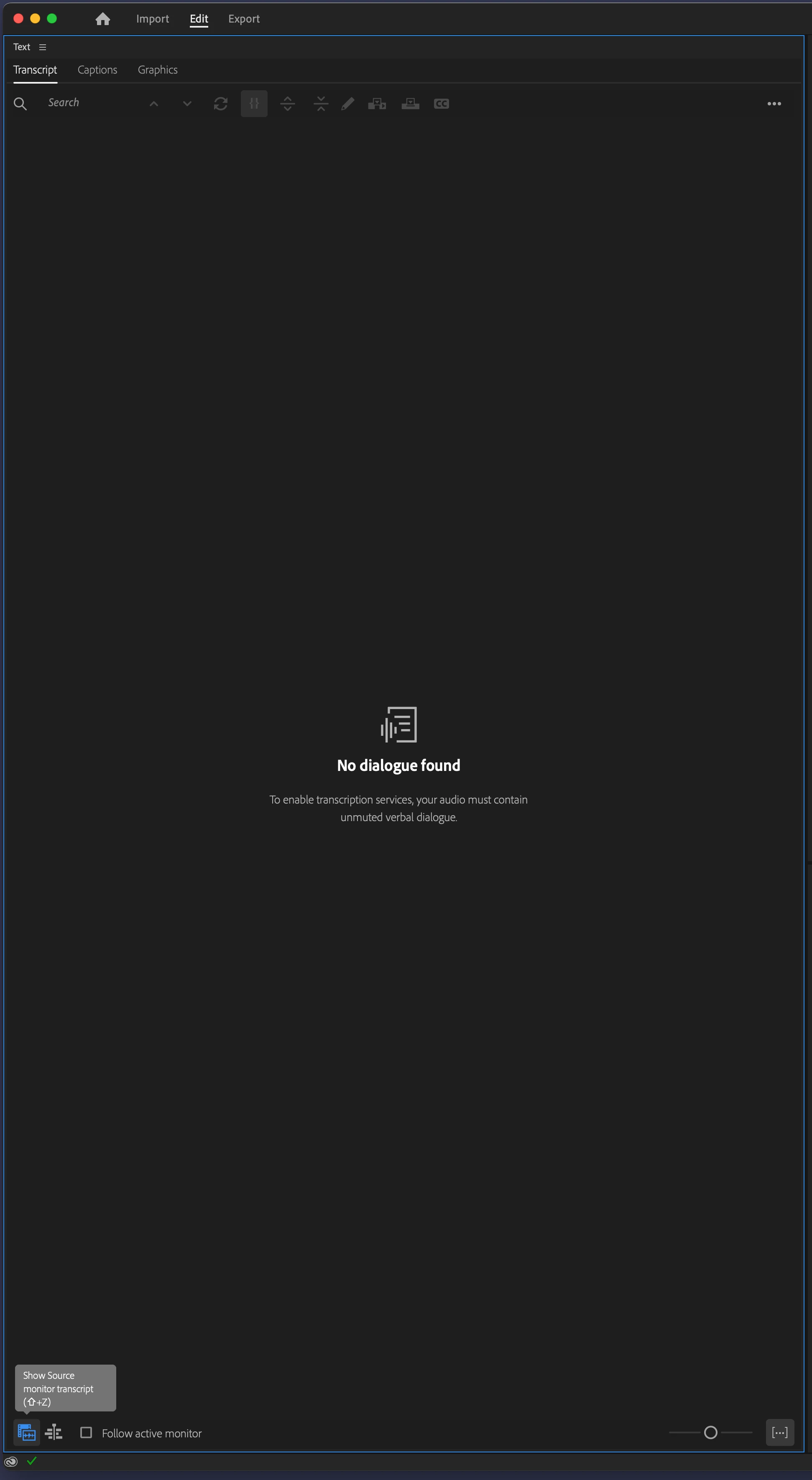

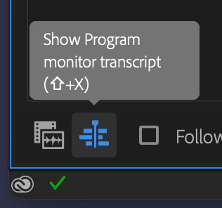

Don't know if this is a clue or not, but when I launch the Transcript function when the "show program monitor transcript" icon is activated, this is what I see...a selected AI Transcription is underway.  However, as you can also see, when the "show source monitor transcript" icon is activated, Premiere says "No Dialog Found".
So, this UI is a bit confusing to me.  Am I using it wrong?  I don't know.
Now, on the other hand, everytime I've attempted a re-transcription when the "Show Source Monitor Transcript" icon was activated and an actual clip was in that window, the transcription has worked.

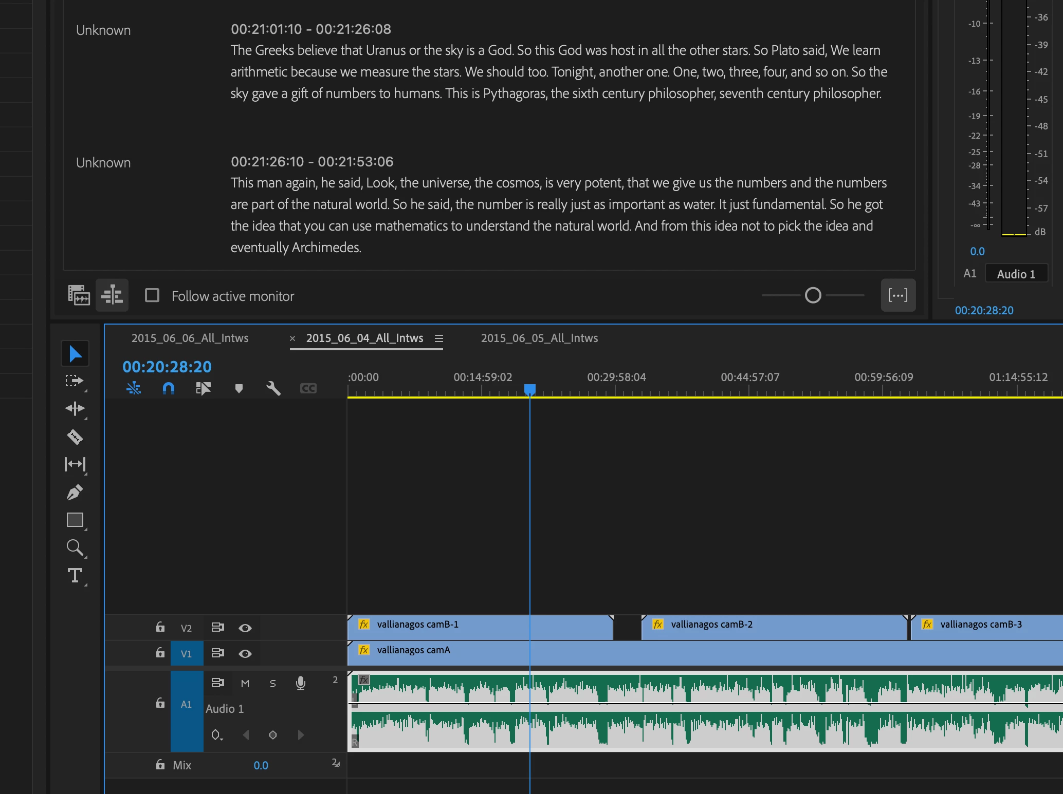

May 24, 2023
So this is a 90 minutes interview that took 30 minutes to transcribe.  It failed to seperate the voices even though "show speakers" is tick-boxed.
So...yeah, now I'll "re-transcribe" again.  As you can see, pretty time consuming when it fails.  Cool service, but I can't figure out how to get it consistent.
