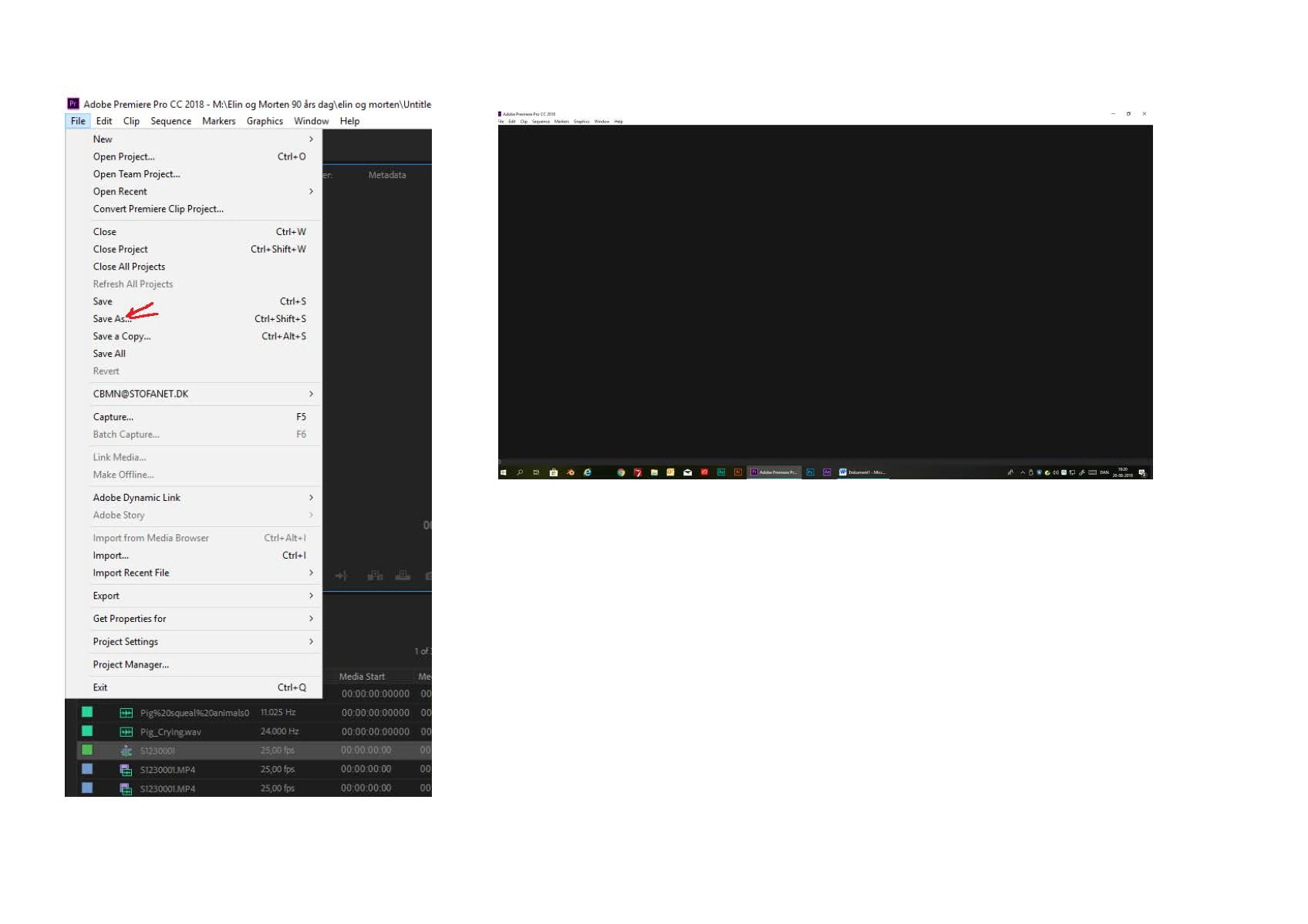

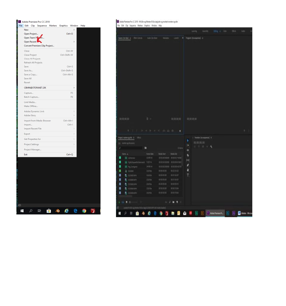

I have a little problem with Adobe Premiere Pro CC 2018. When I save the files under "Save as", the screen goes black, except for the top bar where it says "Adobe Pro cc 2018" and the next line says "file, edit, clip ending with help". I go into file and press "Open recent" premiere Pro shows up but lacks completion of timeline. I press the sequence icon and the clips show up again. I would like to start by hearing different clips, but I cannot. I press the triangle to start it nothing happens. I can shut down completely and start again and then works things. What's wrong and what can I do to make it work??????

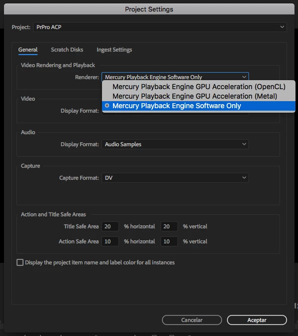

    Or try changing the Mercury Playback Engine GPU acceleration:
    File / Project Settings / General...
    Then change the acceleration to Software Only to test:
    If not works fine, try with other.
    Byron.

    August 21, 2018
    Thank you for taking the time to answer me. For your question, I can tell you the following. I use two monitors. Video card is NVIDIA Geforce GTX 960. I shoot with 4k.  In the premiere pre I use the following resolutions 1920X 1080 or 2560 x 1440. I put Premiere Pro up to DV or HDV, both things work fine.
    I will finish, but thank you for answering me Look at Kevin answer..

    Look on my screenshot

    August 20, 2018
    I have make some screenshot of theproblem and so you can see what I have make. I hope it can help.
