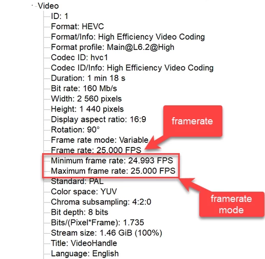

    I have a feeling you do not understand the concept of variable framerate: its not the framerate itself you set in the app but its the framerate mode set by the phone.

    The problem isn’t the specific frame rate number … it’s that the framerate varies. That disconnects the audio and video streams into separate items not at the same speed to begin with.
    That’s why the suggestion to try after converting to CFR in Handbrake or ShutterEncoder was made. As if that does fix this, then the problem is in the nature of the beast of being CFR. It gives an answer to what is causing the issue.

    The reason PeruBob asked for MediaInfo data on the file is to see if it is VFR or CFR … variable framerate or constant framerate. That is a huge difference. There’s another possibility I’ll add below.
    VFR, recorded by some drones, most screen capture apps, and most phones, auto-changes the actual number of frames recorded per second by how much motion it ‘sees’ in the image. So your 25fps shot may actually vary from say 21.2 to 26.3 fps within the clip. That’s hard for most NLEs to handle, as they all prefer CFR as from serious cine cameras.
    So with VFR, sometimes you get odd playback of the audio. That’s one possibility.

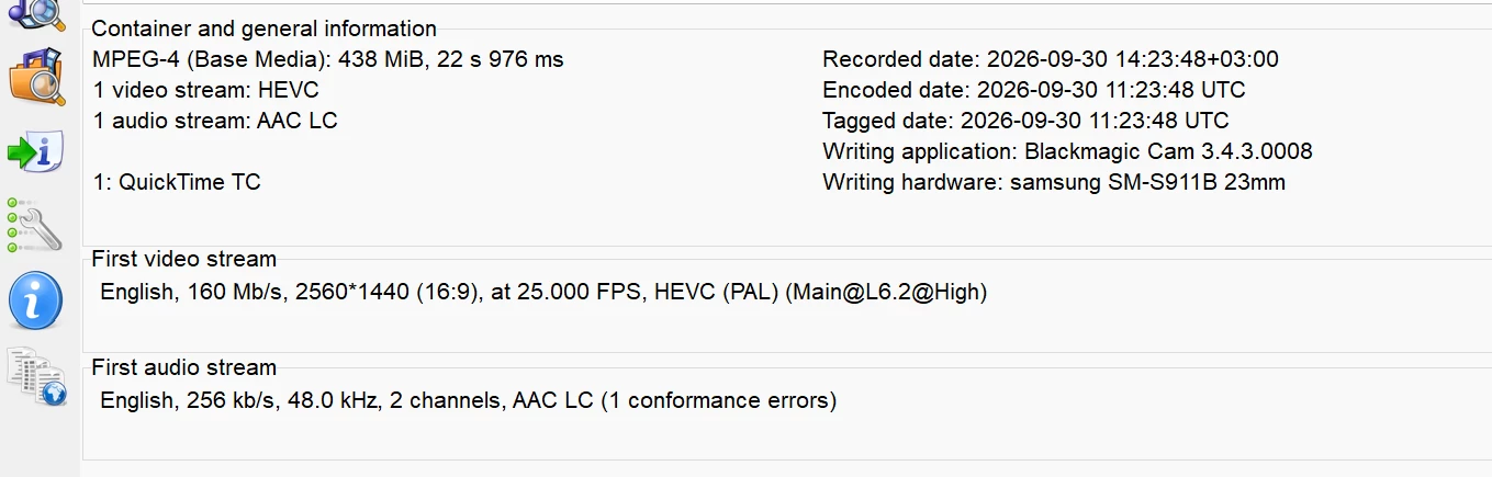

    Please use the free MediaInfo and post a screenshot of the properties of one of the problem media in tree view.
    https://mediaarea.net/en/MediaInfo
    Oct 1, 2026 10:36 AM UTC
    Intel Core i7-14700K 3.4GHz/33MB s1700 BOX MSI MAG Z790 Tomahawk Max Kingston Fury DDR5-6400 65536MB PC5-51200 be quiet! MSI PCI-Ex GeForce RTX 5070 Ti Gaming Trio OC 16GB GDDR7 SSD Samsung 990 Pro 2TB M.2 PCIe 4.0 x4 NVMe 2.0 V-NAND 3bit MLC SSD Samsung 990 Pro 1TB M.2 PCIe 4.0 x4 NVMe 2.0 V-NAND 3bit MLC Toshiba MG Series Enterprise 20TB 7200rpm 512MB MG10ACA20TE 3.5 SATA III Windows 11 Pro 25H2
