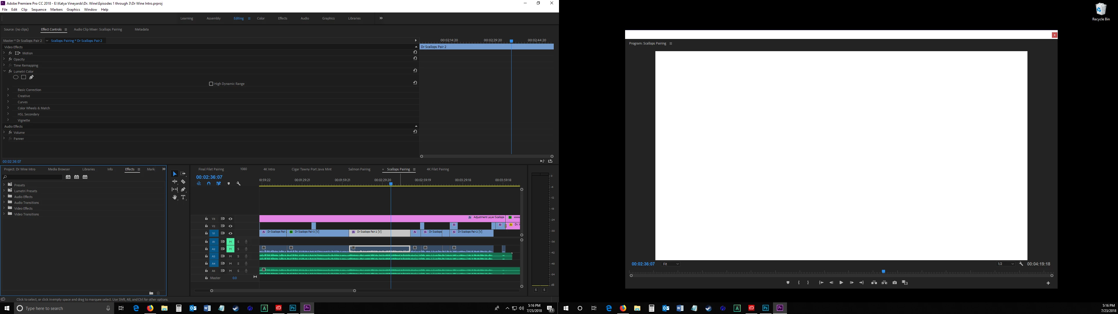

I downloaded drivers manually and tried that route. A few different versions. Did not work. But here is the strange thing. If I unplug my second monitor, then launch the software the footage is visible. Then I plugin my second monitor and can work. But I must do this every single time. What the heck is that?

July 23, 2018
Here is a screenshot when I open Premiere (after having to force close it in Task Manager). Nothing is displaying in the preview.

Try updating or rolling back your graphics driver directly from the video card manufacturer’s site.

Hello Peru Bob, I had actually uninstalled my driver and then reinstalled it from scratch. So rolling back does not appear to be an option. I wish it was. I too believe it is video card related but have no way to test my suspicions. Though AE works fine. Without a glitch.
